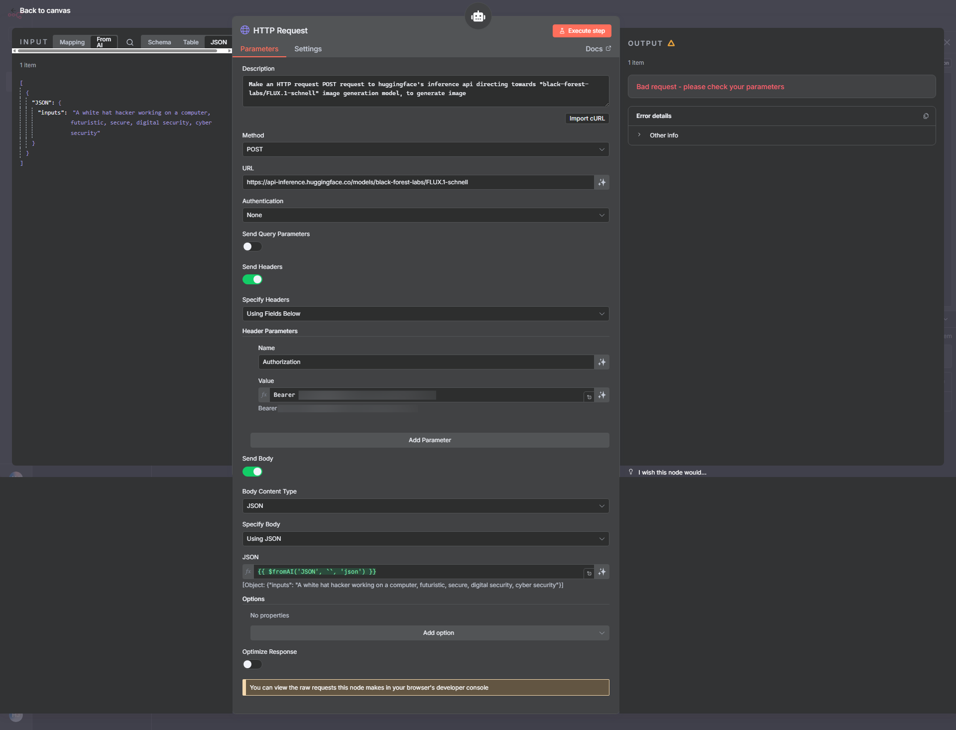

Hi n8n community,
I’m running into an issue using the Hugging Face black-forest-labs/FLUX.1-schnell image generation model in n8n.
Here’s what I’ve observed:
  • HTTP Request node:
    • Method: POST
    • URL: https://api-inference.huggingface.co/models/black-forest-labs/FLUX.1-schnell
    • Headers:
      Authorization: Bearer <YOUR_TOKEN>
    • Body (raw JSON):
      "inputs": "A white hat hacker working on a computer, futuristic, secure, digital security, cyber security"
    Result: Works perfectly, image is returned.

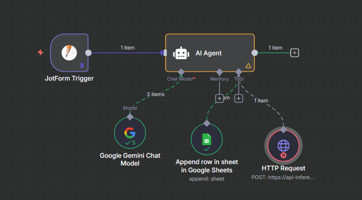

  • AI Agent HTTP Request(as tool):
    • Using the same parameters and body, generated via $fromAI() or similar templating.
    • Correct Content-Type and Authorization headers are included.
      Result: Fails with:
What I’ve checked:
Question:
Has anyone successfully used Hugging Face image models in AI Agent HTTP Request nodes? Could this be a templating/formatting issue specific to AI Agent, or is there something else required for image generation endpoints?
Any advice would be greatly appreciated.
Thanks!

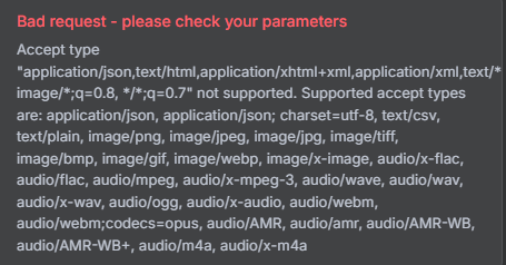

Hi @Vivek_Saradva
I tried the HTTP node as you said, but I got the following error:
This means the Accept header needs configeration:
Once I added it, it worked correctly (in the HTTP node).
However, this explains the issue when using HTTP as a tool to generate image(binary),
If you add that header in the HTTP Tool, it will work, but you’ll see the following:
This means that tools inside the AI Agent cannot return a binary file.
The solution?
Redesign your workflow so that image generation is handled with an HTTP node (not as a tool), placing it either before or after the AI Agent depending on your logic, and If you still want to use it as a tool, wrap it in a sub-workflow and make sure it returns text rather than a binary..
