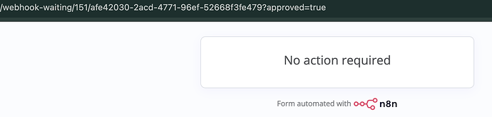

However, when I add a Telegram node as a tool for the Agent (Agent Tools) and the process changes to “send and wait for response,”
the Agent uses the tool and sends the approval message. But when I open the link from Telegram, the page displays the text:
No action required
and nothing happens. The Agent remains in a ‘working’ or ‘waiting’ state until I manually stop the process.

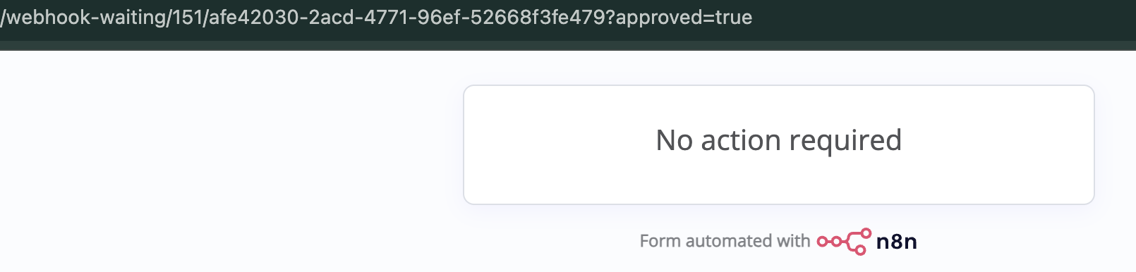

I am also running a workflow that requires a response and I am getting the same error. This time using a gmail node. Any solution?
I’m in the same situation, No Action required, no matter what option I select (approve / Reject )

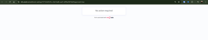

Same here. Redirect URL is correct, but I get “No Action Required”.

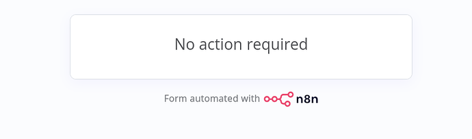

Same for me. " No action required". All field filled, but it doesn’t work. How to bug report, guys?

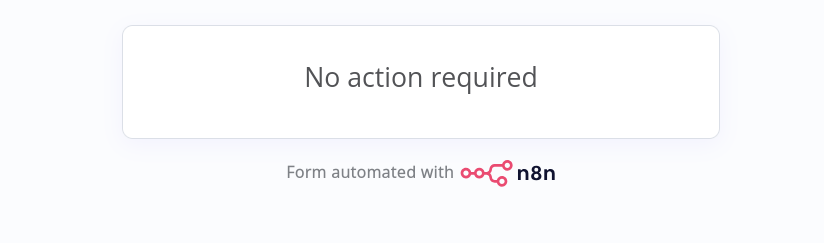

Ciao everyone, finally I’ve solved the issue, it is not a bug, it’s the approach, you cannot use a HITL inside the AI agent, while you need to put the HITL node as the next action after the AI node like the image below, refer to the Telegram node. Hope this helps !
if its not a bug, why there is an Agent Tool which allows that…
good question, and you are right , it is a bug but you can still use another way to achieve the result .
