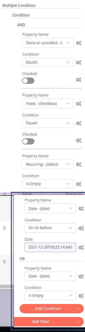

I am currently working on some automation in notion, I would like to get pages with this filters:
Like you can see I got 12 pages as return, in n8n I made this:
And got 15 pages on return
Could some1 please explain to me how to filter correctly pages if I have and and or in one block like I am 5. Because TBH making filters with “groups” is pretty tricky for me, I feel lost

I don’t understand why for each condition we define and or or. I we have two condition we say “1 or 2” or “1 and 2”, but in n8n we “1 - or, 2 - and”. I don’t got it ;C

As far as n8n is concerned, the filters configuration you have set would be passed on to the Notion API. So when setting something like this in my own workflow’s Notion node:
n8n would send a filter like this to the Notion API:
    "filter": {
        "or": [{
            "property": "Abgeschlossen",
            "checkbox": {
                "equals": false
        "and": [{
            "property": "Status",
            "text": {
                "starts_with": "The shipment "
So n8n would just take the information and add your filters to the respective API request rather than doing any processing itself. You can actually see the request when setting your log N8N_LOG_LEVEL to debug.
So with this in mind you’d need to check with Notion’s support team how exactly they resolve such API requests. Their documentation simply says “Filters are similar to the filters provided in the Notion UI”.
That said, I am not sure this would give you the like I am 5 answer you are after. So you might save yourself some hassle and simply set the less restrictive OR filters on the Notion node and then do the additional filtering afterwards in n8n using the IF node.
