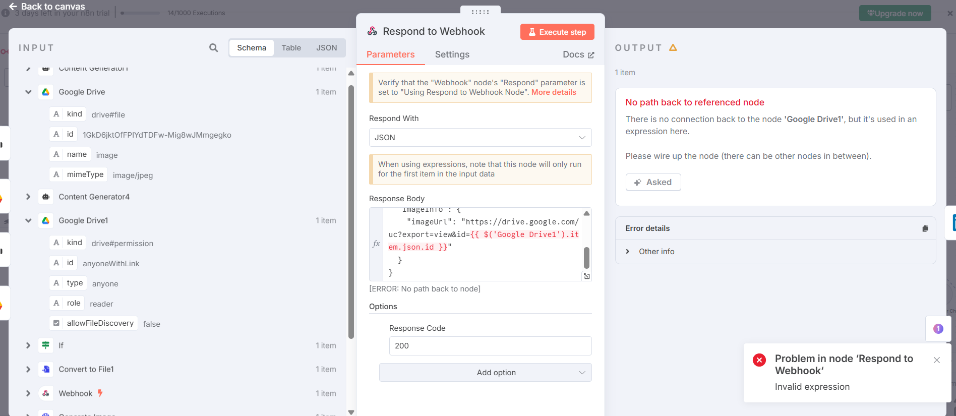

I am constantly getting error related to google drive. Can anyone please help me out

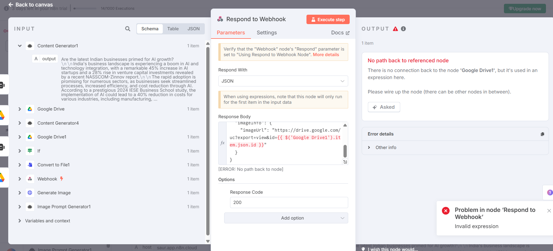

I have shared my whole workflow as well as error images. I have the field with the exact name in my input panel. Yet my webhook not recognising it and throwing the error. I used many methods like directly joining it to webhook or removing it bt not able to solve it.
I want the url of my uploaded image so that i can give it to webhook.
do you have an image of the Google Drive1 in input expanded? it could provide more information.
it may be that you are using the wrong ID. did you try to use the ID from the google Drive instead of google drive one? also have you checked the documentation of how your output to your webhook should be?
