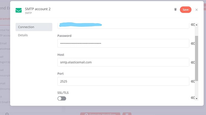

Hi @Suchitra_Giri, the error message suggests n8n and the server couldn’t agree on SSL encryption.
Could you try setting up your email credentials like so:
So your username + password as shown by Elastic Email:
Host = smtp.elasticemail.com
Port = 2525
SSL/TLS = Disabled

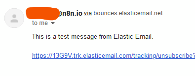

This appears to have worked fine for me and the message arrived in my inbox a few minutes later:
@MutedJam Thanks for your help, I am doing all the things but still getting error, and I am sure that I used correct credentials!
