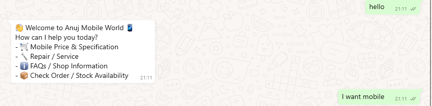

I am Making A whatsapp Chatbor And execution is only performing once

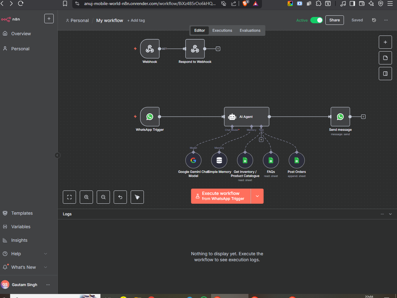

when I clicked on execute workflow button and messaged first time on whatsapp the n8n execution replied back but STOPPED , And when i messaged 2nd time nothing happened PLS HELP
Hi there, this is because you are on testing mode, everytime you hit execute workflow button, it will only be active once
If you want it to always be active and andwer you all the time, you need to toggle the button on the top right from inactive to active
This way, it will always be active and reply to any message you send
