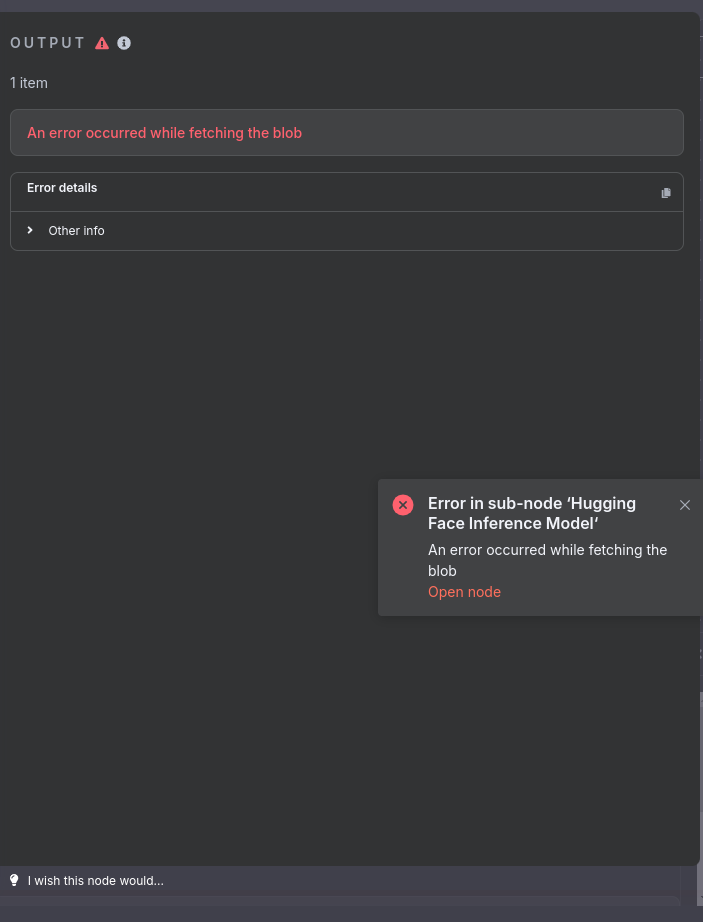

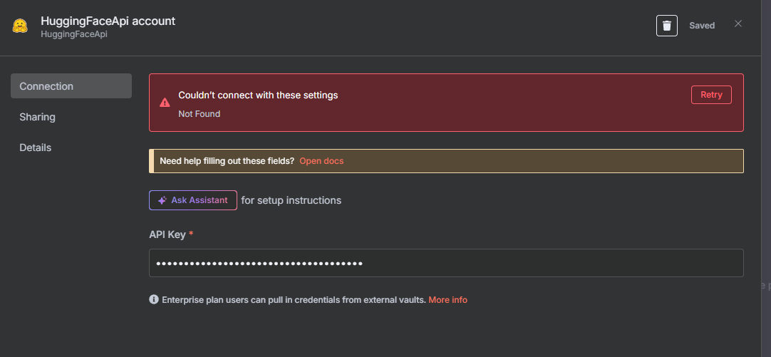

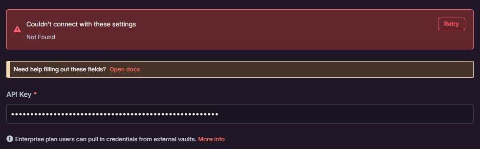

I am unable to connect my huggingfaceapi account with n8n
I have copied my Hugging face acess token to the n8n credentials but when i save the api key it shows the below message in the screen shot. also i am sharing the error it shows when i run the workflow with Hugging face llm model.

![Screenshot from 2025-05-08 21-24-58|690x430](upload://aJRCDNtr6PiueZFkVsIrfovbnPW.png)

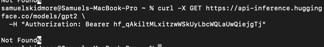

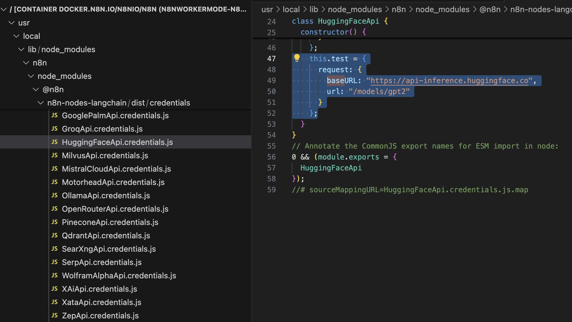

I am having the exact same issue. It was working on April 30th, immediately after no luck. I tried generating 5 new keys with varying permissions to no avail. I have also tried running curl commands with my key which are successful, so i know my token is not the problem.
Best I can guess is that there was an update on either n8n or Hugging Face side, and the endpoint it is hitting is no longer valid. However, n8n gives us no way to see what we are hitting, therefore we cannot troubleshoot. Hopefully someone can come up with a solution!
I can confirm the same issue,
After adding the API, the test failed and returned a “Not Found” error.

As you mentioned your api key was working with curl command can you share the command ? . i am recieving a no found error with curl i believe there is an error from the api url.
Same Issue here. Self hosted docker. Curl api test works.
Here is a request working @anaskhan you need your token to add.
The error we see Not Found, seems to be a 404 Not Found status code

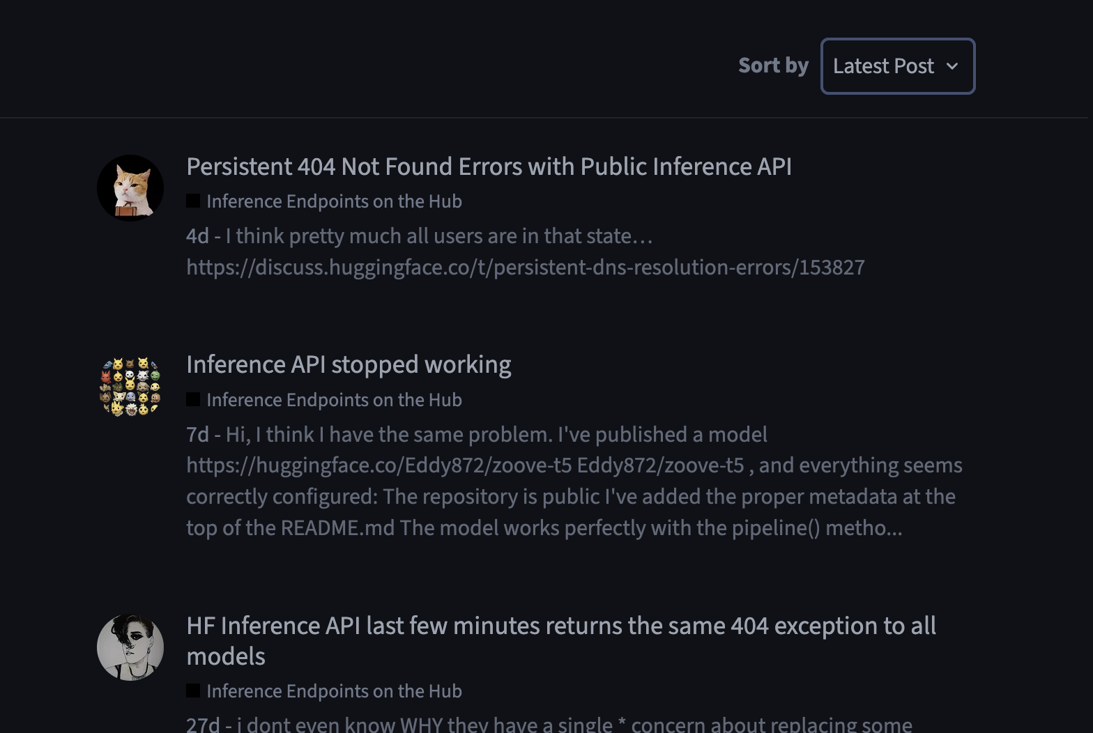

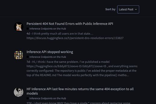

Seems to main issue is Huggingface switching to inference providers
Even when calling in curl, same error so it looks like a major rework needs doing to fix with inference providers maybe?
token deleted btw :wink: incase anyone tries to use lol.
Unless this is a tempory issue which huggingface is fixing :man_shrugging:
