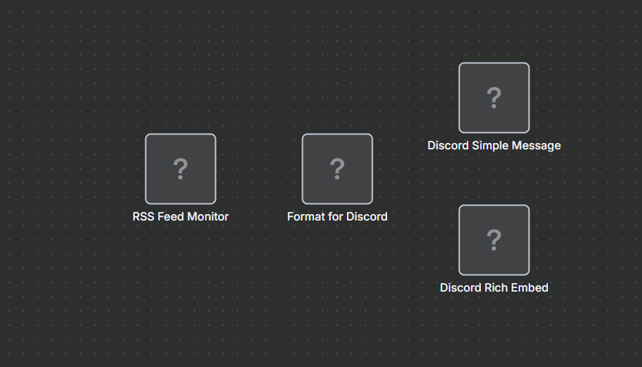

Sounds nice! But i tried it with several use cases, including your “Build a workflow that monitors RSS feeds and posts to Discord” use case.
Hi freddy! I am glad you checked it out! The key here is to use Project and have system prompt with instructions (included in the github repo) - I also included templates in the tools, so that should improve the outputs. Also, be sure to use Opus 4 with extended thinking. Let me know if it helped!

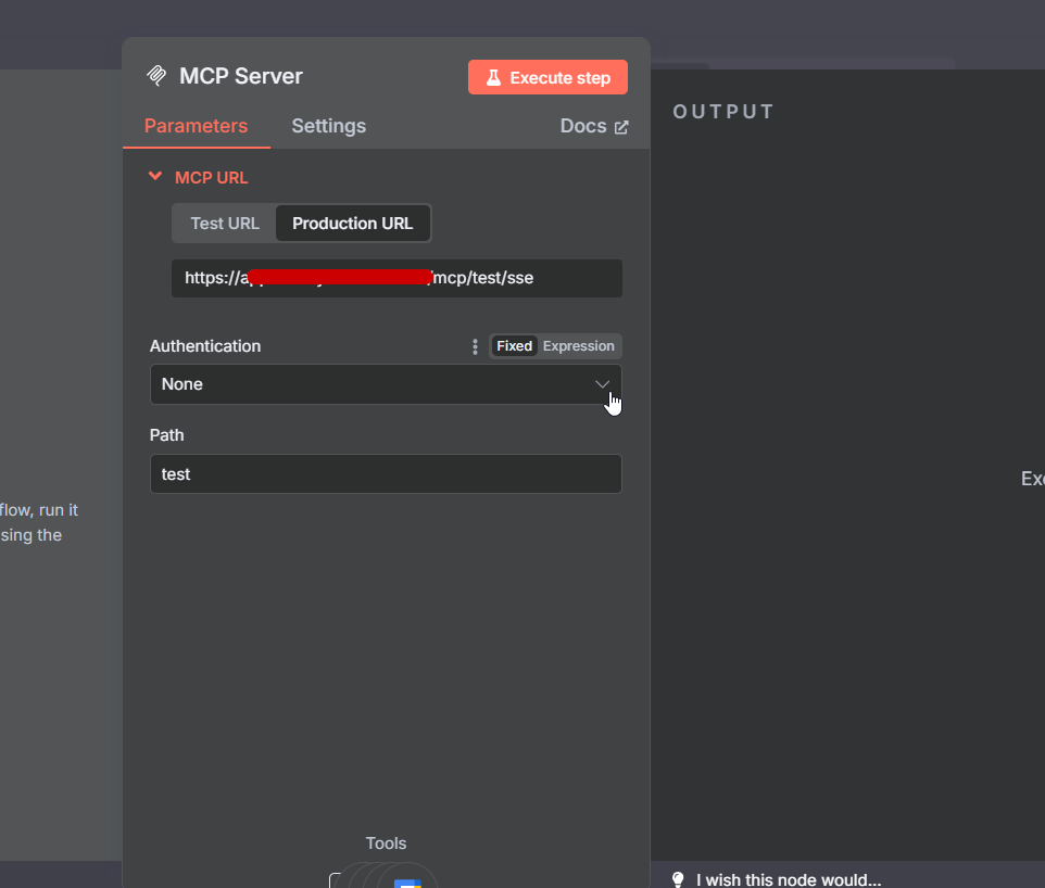

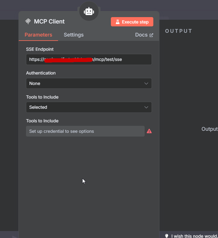

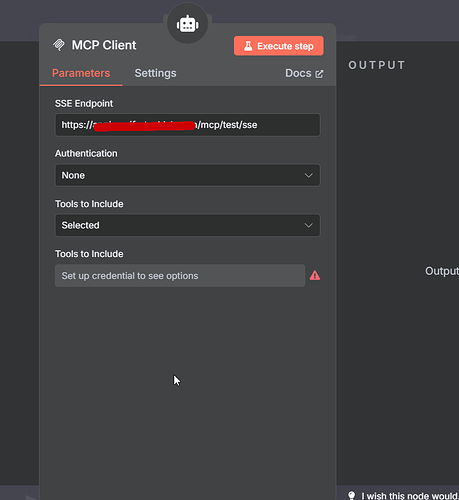

I am facing the following error, working with n8n Version 1.100.1 and n8n running in docker without any proxy all works fine (telegram too) now when I try to configure a mcp server I get the correct URL and checking with cursor it works fine. The issue is with the MCP client, I can´t see the MCP server. Any help please?
Hi! connecting to AI Agents in n8n does not work yet - here you can follow the issue resolution
Hey thanks for your great work!
I’m running into an issue where i tried with multiple models from openai and from anthropic
tried multiple scenarios
but 90% of the time its creating flows with faulty nodes

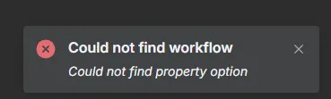

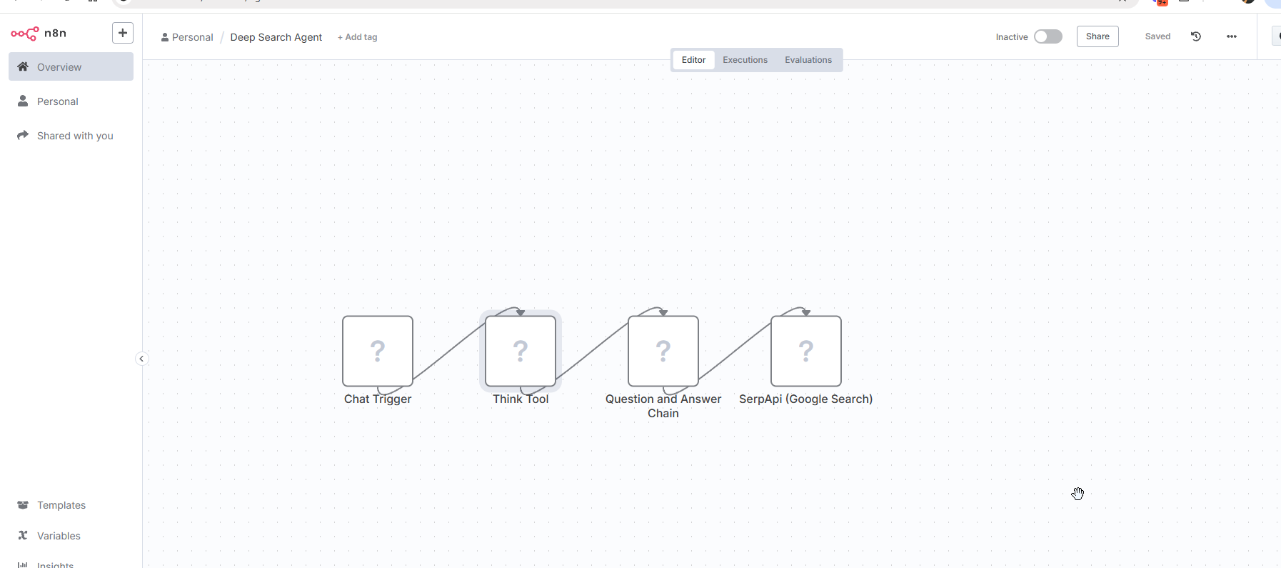

Not sure where to address this issue - but if the Claude hallucinates something, even though it’s supposed to “validate” the workflow nodes, the n8n UI can’t load the JSON workflow. As result, yo get an “empty” project, and this error " propertyValues[itemName] is not iterable", or anything alike:
I understand that Claude might hallucinate stuff, but it’s impossible to work around this, when the n8n UI doesn’t show even which node and what property is invalid.
Any ideas on how to resolve this?

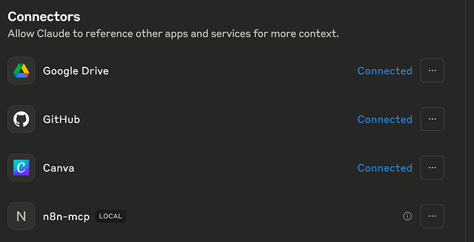

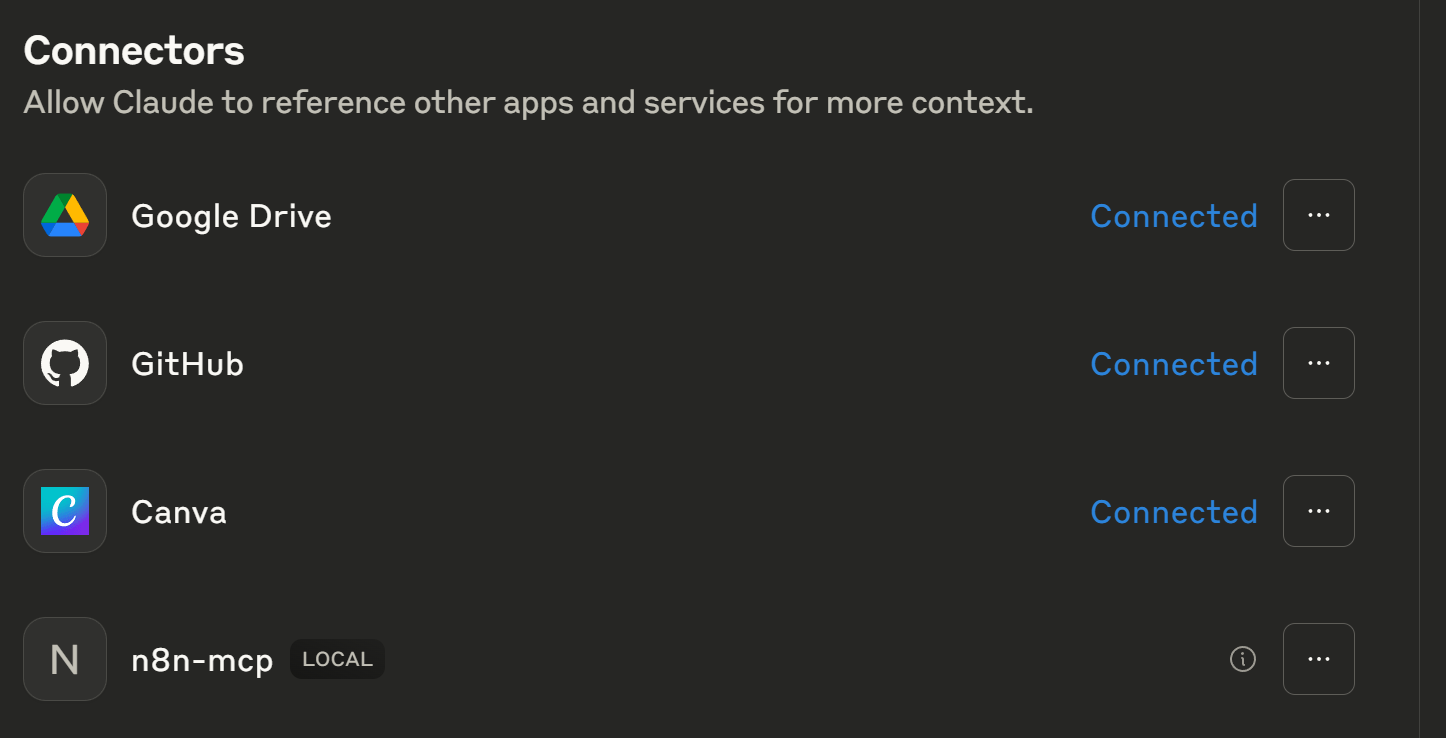

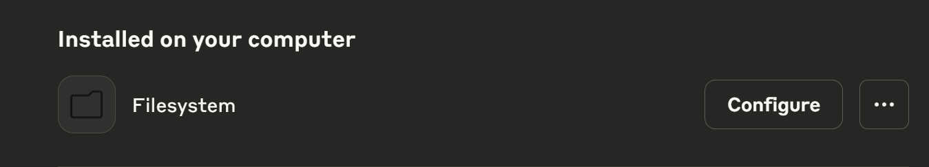

If it matters, my project knowledge is only about 6% full, and my active integrations look like this:
and
I’m wondering if I should expect Claude to be able to use the n8n-MCP server for larger conversations than I’m currently experiencing. Perhaps there is an install step I missed or an add-on I forgot to enable.
