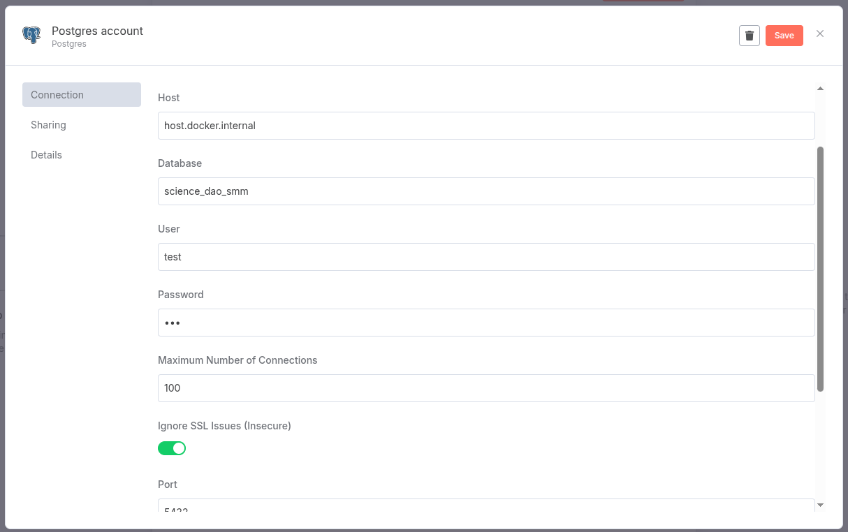

I cannot connect to Postgres on host.docker.internal
I can’t connect from the Docker to host.docker.internal.
The following (on the host) works:
psql postgres://test:123@localhost:5432/science_dao_smm
ping host.docker.internal does work inside the docker.
The docker command:
docker run -it --rm --name n8n -p 5678:5678 -v n8n_data:/home/node/.n8n --add-host=host.docker.internal:host-gateway docker.n8n.io/n8nio/n8n
What did I do wrong?

No, I use Linux.
The error was that my PostgreSQL allowed connections only from localhost and contrary to what I expected the address of Docker as visible from host was not 127.0.0.1.
After I fixed PostgreSQL config, it works.
