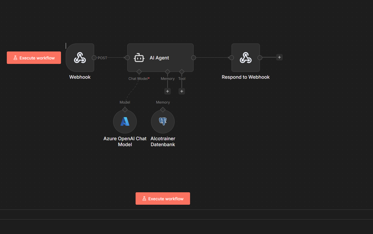

I need some help with my Webhook
Hallo Together,
I start to build my Webhook to my homepage, the problem what i got, the workflow ist work in n8n but the connection with my system is not available.
Im connecter with a docker, in nano i put the right link, I also make my Main.py according.
i dont know what to do, and need some help, how to test or what can i do..
Im quite new, so this should be a easy task but somehow its not.
Hi @GaborBS, welcome to the community.
Don’t worry, this happens to everyone at the beginning.
If your workflow works inside n8n but your Main.py or homepage can’t find it, it’s almost certainly a docker issue.
I guess n8n is running in Docker, “localhost” inside the container isn’t the same as “localhost” on your pc.
Can you trigger the webhook using an app like Postman or even just curl from your cmd?
If that works, the problem is in your Python code. If it doesn’t, the problem is how Docker is exposed to your network and the localhost.

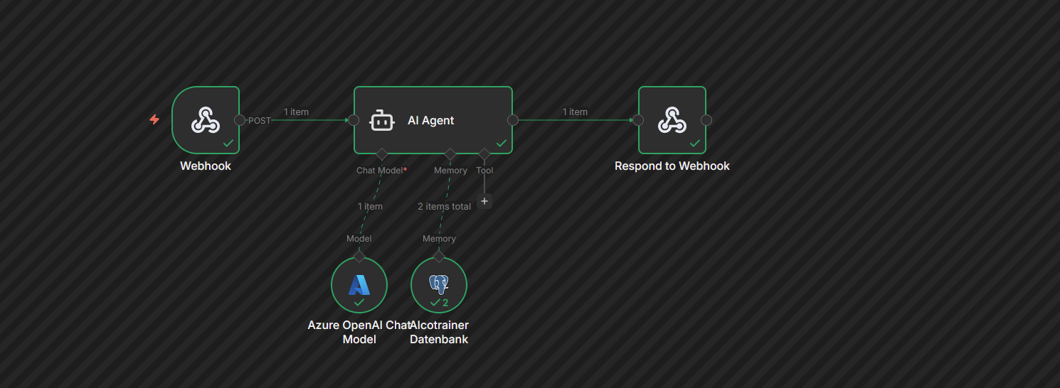

Hi @GaborBS Welcome to the community!
What i have understood is that you are trying to call a URL which is of this workflow which takes webhook given parameter as input and it gives it to AI agent and return back the output which i guess you are trying to display inside your Main.py, for now let’s consider a basic workflow which is very similar to this one which is:
And now in this workflow it is very straightforward that the webhook passes Prompt parameter to the AI agent and it computes it and returns the AI output using respond to webhook, now for calling this kind of workflow your pythong Main.py should look like my .py file which is:

You can always change the Prompt parameter i was testing this to showcase you so i have embed that parameter in the URL itself, so here if you will execute this your output would look like this:
[Running] python -u "c:\CODE_SPACE\testCase.py"
Status Code: 200
Headers: {'Content-Security-Policy': 'sandbox allow-downloads allow-forms allow-modals allow-orientation-lock allow-pointer-lock allow-popups allow-presentation allow-scripts allow-top-navigation allow-top-navigation-by-user-activation allow-top-navigation-to-custom-protocols', 'Content-Type': 'application/json; charset=utf-8', 'Content-Length': '59', 'ETag': 'W/"3b-eRtVrj3uhkpwvIGLl5FLa9rq9b0"', 'Vary': 'Accept-Encoding', 'Date': 'Mon, 16 Feb 2026 06:02:47 GMT', 'Connection': 'keep-alive', 'Keep-Alive': 'timeout=5'}
Response Body:
{'output': 'Hello World back! What can I do for you today?'}
[Done] exited with code=0 in 1.886 seconds
So you can see the output parameter it has returned, if you configure your workflow correctly and just change the url variable in this python snippet your instance would also work. Let me know if you have any errors related to this.
