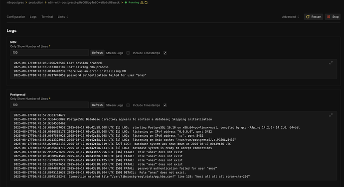

I restarted my n8n instance self hosted on Coolify with postgres and I am running in to some issues (apparently password authentication failed and
I went ahead and restarted my n8n instance that is self-hosted on Coolify. I had a postgres db attached to it too, and after restarting I am getting the following error.
So this is from my n8n instance logs in coolfiy:
2025-08-17T00:15:33.809050299Z Permissions 0644 for n8n settings file /home/node/.n8n/config are too wide. This is ignored for now, but in the future n8n will attempt to change the permissions automatically. To automatically enforce correct permissions now set N8N_ENFORCE_SETTINGS_FILE_PERMISSIONS=true (recommended), or turn this check off set N8N_ENFORCE_SETTINGS_FILE_PERMISSIONS=false. 2025-08-17T00:15:35.296273291Z Last session crashed 2025-08-17T00:15:45.302520828Z Initializing n8n process 2025-08-17T00:15:45.948291945Z There was an error initializing DB 2025-08-17T00:15:45.948773899Z password authentication failed for user "anas" 2025-08-17T00:15:50.699167388Z Permissions 0644 for n8n settings file /home/node/.n8n/config are too wide. This is ignored for now, but in the future n8n will attempt to change the permissions automatically. To automatically enforce correct permissions now set N8N_ENFORCE_SETTINGS_FILE_PERMISSIONS=true (recommended), or turn this check off set N8N_ENFORCE_SETTINGS_FILE_PERMISSIONS=false. 2025-08-17T00:15:51.992864553Z Last session crashed 2025-08-17T00:16:01.998511428Z Initializing n8n process 2025-08-17T00:16:03.001359430Z There was an error initializing DB
And this is from my Postgresql logs also self hosted, n8n:
2025-08-17T00:16:36.366577121Z Connection matched file "/var/lib/postgresql/data/pg_hba.conf" line 128: "host all all all scram-sha-256" 2025-08-17T00:16:36.918488459Z 2025-08-17 00:16:36.918 UTC [136] FATAL: role "anas" does not exist 2025-08-17T00:16:42.009373494Z 2025-08-17 00:16:42.008 UTC [143] FATAL: role "anas" does not exist
I never changed the password or anything for my postgres database so idk wtf it is talking about… It has alwauys been the default setup. Someone please help me with this, I got a lot of workflows on my instance.
