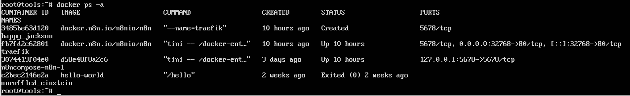

Hi, I tried to update my N8N to the latest version. But since I’m a docker Noob, I ruined it. Can anybody tell me what commands I need to run to restore my n8n setup?
Please let me know if you need any other information.
I run Docker on a vps, so only have novnc commandline access.
Any advice on how to update without mistakes, is also welcome.

I just found out it seems my n8n wass installed using docker compose.
What is it that is ruined? When using Docker to update n8n, it is usually enough to change the image version number in your docker compose file and then restart. Doing that, n8n should be updated without affecting any other part of your system, including workflows, credentials, etc.
To restore your n8n with Docker, set the previous version number in your docker compose file and restart.
For example, if you want to updatde/revert to version 1.78.1, set your image like so in your docker compose file: image: n8nio/n8n:1.78.1
Thanks for your suggestion. I guess I removed my image and now the port and enrtypoint settings are lost. But I will try to use compose.
It was my mistake I didn’t know compose was used. So I followed the regular instructions and removed the traefik image. There I guess it went wrong there.
I guess I will have to wait and monday ask the genius of my hosting company who installed it for me, to fix it. Docker in command line is not fool proof :wink:

My hosting company restarted N8N using compose, and it works again…no data loss, and updated to latest version.
So it seems:
if you used compose, you should not try to update the ‘normal’ way. That was my mistake. Besides not knowing what I was doing. But I guess thats the way most developpers learned their job… :wink:
