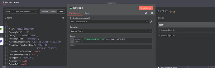

I’m trying the node IBM DB2 in my n8n test installation, to execute a query to my AS400 server. So I’ve added the module, and this module seems to work fine. I can query a static SQL and get the result, with no issue
But the problem is that I would like to execute a query that uses JSON data as input.
seems that my JS code written like this : {{ json.xxxxxx }} is interpreted by the query as text, and it is not using the value of the result of the JS code.
See below the workflow :
As seen in the screenshot, it returns the json.xxx text, instead of the result of the json.xxxx value : it should result 2 lines with ‘ADAVD’.
So I’m wondering if I 'm doing something wrong ?
Thanks for your help.
Regards,
Nicolas

Hey @NicolasB,
We don’t have a DB2 node so I suspect you are using a community node, It would be worth raising this as an issue with the node creator as I suspect there is an issue with the output they are returning.

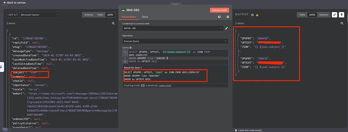

I’ve checked this version 1.0.3 .But it seems the result is the same :
I’ve tried to run a simple query, the preview/result in the middle of the screen is understanding my $json.subject correctly. But the output of the node is still giving the {{ $json.subject }} instead tof the “user” value.
So if I tried to use this Subject value to the Where statement of my query it doesn’t work.
That finally works, I had to restart my n8n docker to clear cache. Big thanks to @tmorello !
