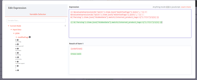

I’m trying to use else condition in set nodes (expressions) i’ve about 40 items, so the best way to achieve this is using the expression ineasted of ~40 copies of IF/SET nodes.
The issue is I tried to do this using Add else Condition in IF nodes Expression solution and using Add else Condition in IF nodes Expression - #4 by sirdavidoff. solution, both not working with my expressions:
Current expression: {{ $evaluateExpression($('Split').item.json[\"modifiedTags\"].join(', ')) ? $evaluateExpression($('Split').item.json[\"modifiedTags\"].join(', ')) : $('Parsing').item.json[\"HiddenData\"].match(/internal_product_tags:\\[\"(.*?)\\\"]/)[1] }}
What I want:
If this {{ $evaluateExpression($('Split').item.json["modifiedTags"].join(', ')) }} undefined, then output this: {{ $('Parsing').item.json["HiddenData"].match(/internal_product_tags:\["(.*?)\"]/)[1] }} And if both had value, then output the first one only.
Getting undefined when there’s a value in the second expression in this case which is cross-sale:

Would you be able to provide some sample data as well in JSON format? Your set nodes are still referencing previous nodes, and it’d be helpful to see the full context of what data you’re working with.
@EmeraldHerald Sure, but the code is too long to paste here, so I uploaded it to Gist: https://gist.githubusercontent.com/ARHAEEM/e3d0835a1db07302a75e5c6e280c8665/raw/829f2b0a16b499a4a8df5da22012ac31e6b7a428/umimJV0gfQ.txt
The reason for using two expression is sometimes the internal_product_tags value is (Variable) like: internal_product_tags:x,s,a,d and sometimes it can be a value like internal_product_tags:["Cross-sell"]. so the first expression to get the value of variables, and the second expression to get the value without virable. Both can’t work in same expression, even when use ?: method.
