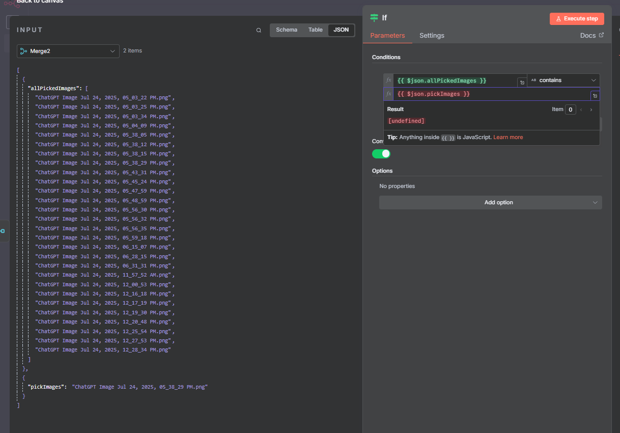

IF node - Error Undefined
Im trying to do is randomly pick image in my local folder and then all picked image will goes to used_image folder. Then i listed all the Picked Image and the current picked image .. then i want the IF node to do is if the allPickedImages (previous images) contains pickImages (current) .. the workflow will try again to pick another image that is not already picked.

              "leftValue": "={{ $json.allPickedImages }}",
              "rightValue": "={{ $json.pickImages }}",

Hey @R1ghTsS hope all is well.
Try changing the Merge node from Append to Combine with All Possible Combinations.
thank youuu!!
