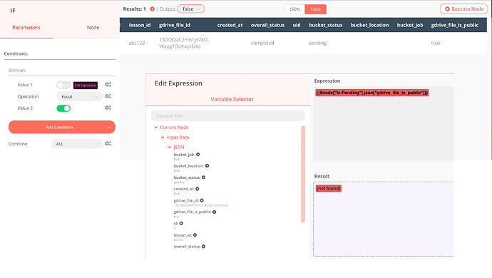

I’m still struggling with these IF statement builders though! I have a Postgres database that outputs an “gdrive_file_is_public” boolean, and I still can’t work out how to make an IF node return anything other than false based on that column! Like I said - I must be doing something fundamentally wrong here with the UI. Feels like I’m misunderstanding something very basic about it!
When I’m building the IF statement, I click on the part of the JSON structure I want to use, it says [Not found] in the UI in orange, despite the left hand object browser panel showing the key and the value are present. Perhaps this is the problem?
I’ve combined both views into this image so you can see the problem. I can’t upload more than one image as a new user here.
Just following that up with an observation. If rather than using the input data for that node, I click on the list of Nodes and select the node at the beginning of the flow that fetches the data from postgres, this display goes green and I then DO get a result from this IF node! :tada:
Why can’t you access the data that is being piped to the IF node though? That seems quite counter-intuitive.
Not exactly sure what is going wrong in your workflow but the Expression-Editor always displays the data from the first output. So if you reference data from an IF-Node that could be a problem. In this case I would recommend you to add a NoOp-Node to the “false” output and reference the data from there.
The Expression-Editor is currently not a perfect tool. It is just there to make the life of people easier when developing workflow. But no matter what it displays, when the workflow gets executed n8n will execute correctly.
