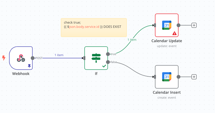

I need to either insert or update a Google Calendar event. I have an IF node where:
• The TRUE branch updates the event if a calendar event ID exists.
• The FALSE branch inserts a new event if no ID is found.
Issue
The initial webhook payload is only passed through to the TRUE branch.
Question
Is there a way to ensure the payload is also passed to the FALSE branch?
You can try using a switch:
The end goal is to get the condition to evaluate as true, so you can simply negate your if condition as the second option.
perfect… thank you
