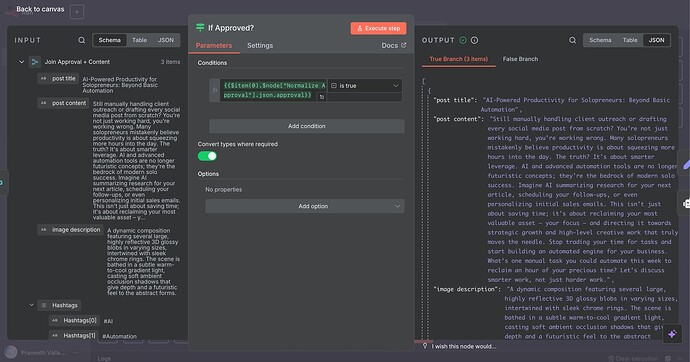

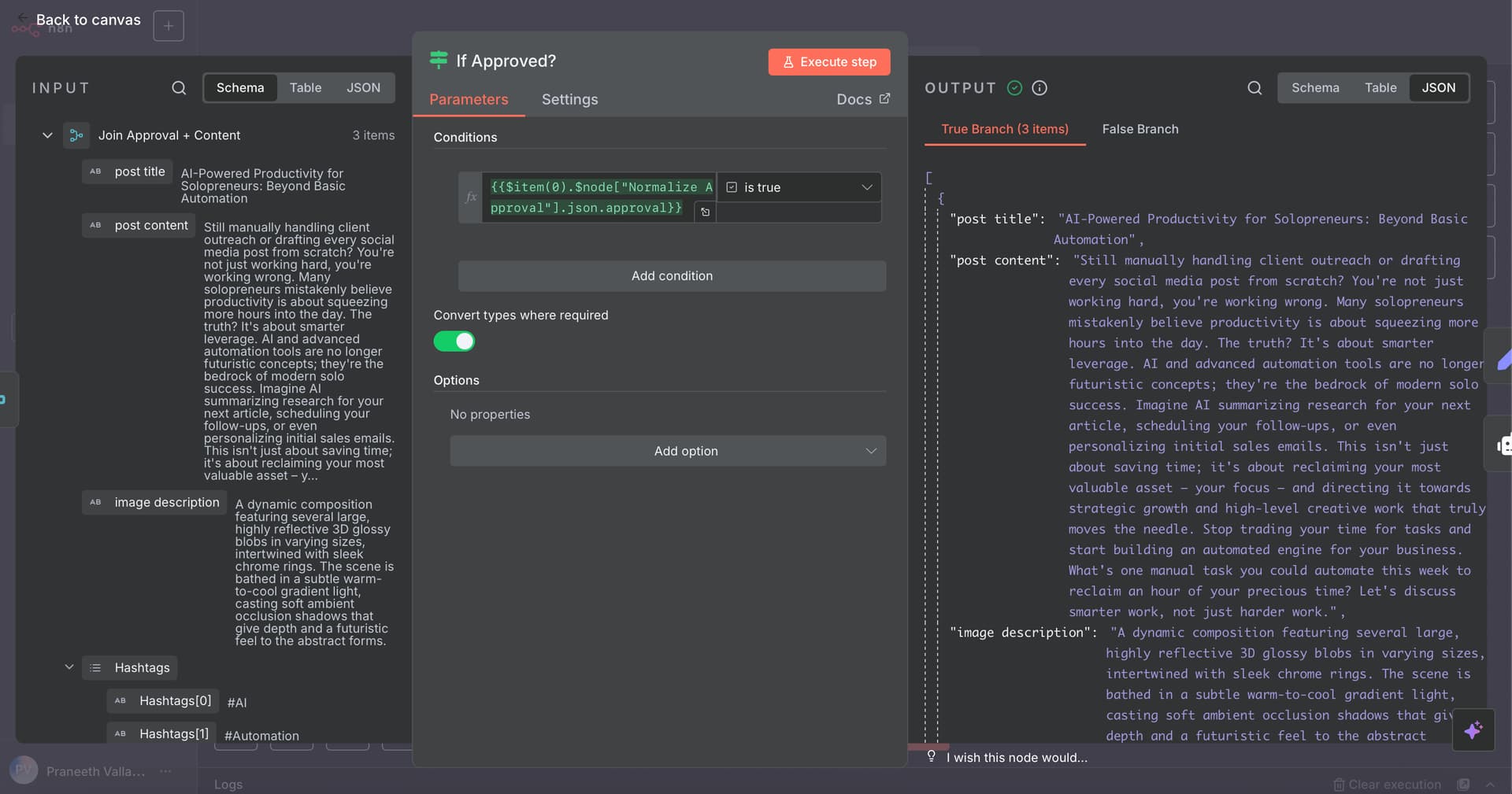

IF statement kept throwing false option even when the input is true
My model kept the IF (false) statement even when the selection is true.
  • n8n version: Version 1.109.2-exp.0
  • Operating system: Mac Linux
can you share the workflow or the if validation and the data that you use for the statement?

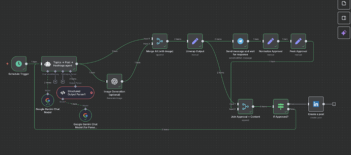

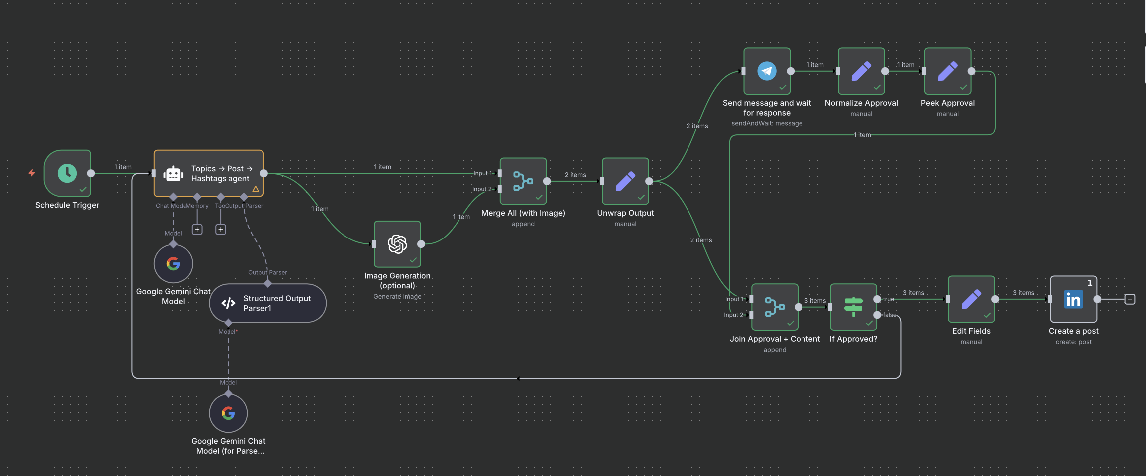

I managed somehow to make it work (don’t know if I done right or wrong), but if you look at my work flow

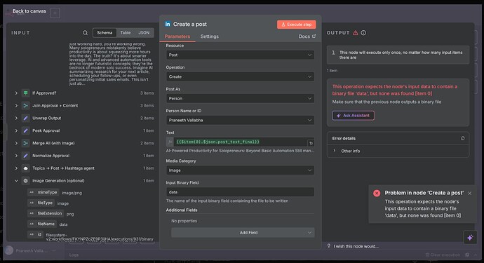

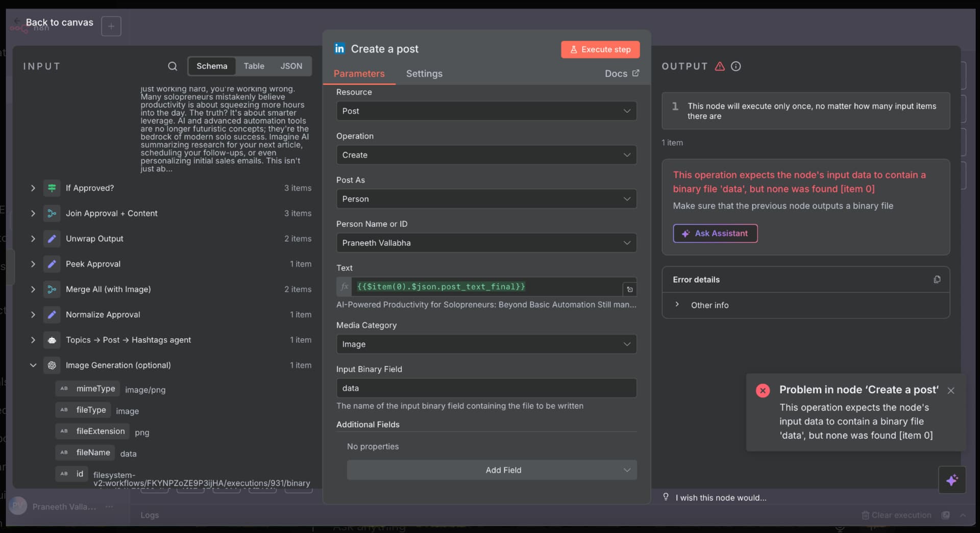

when posting both images and text to linkedin it is showing an error of
this has been a persistent issue for me. And I changed models and tired different methods but couldn’t able to fix it. Please help with some suggestions

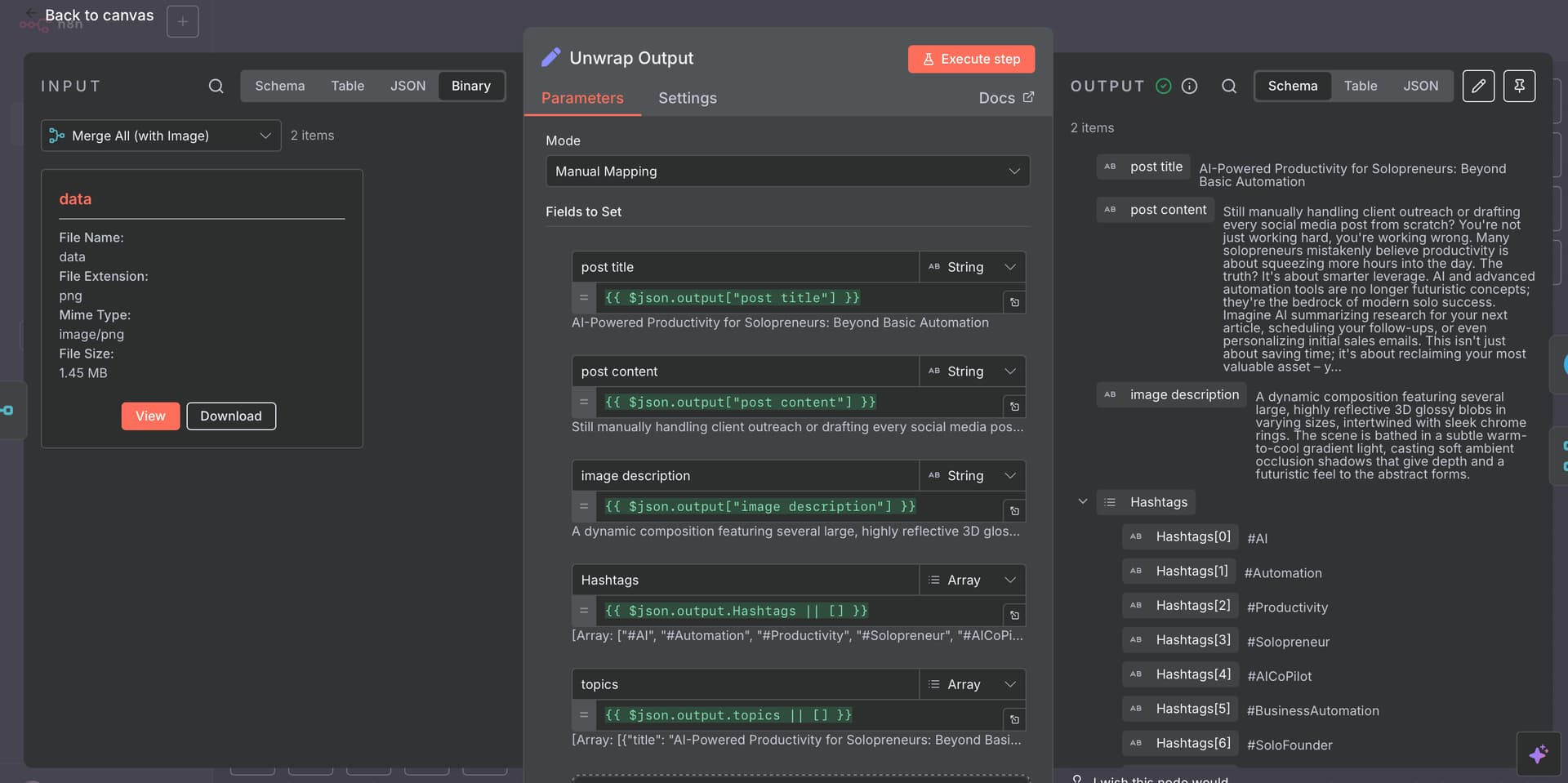

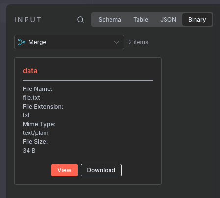

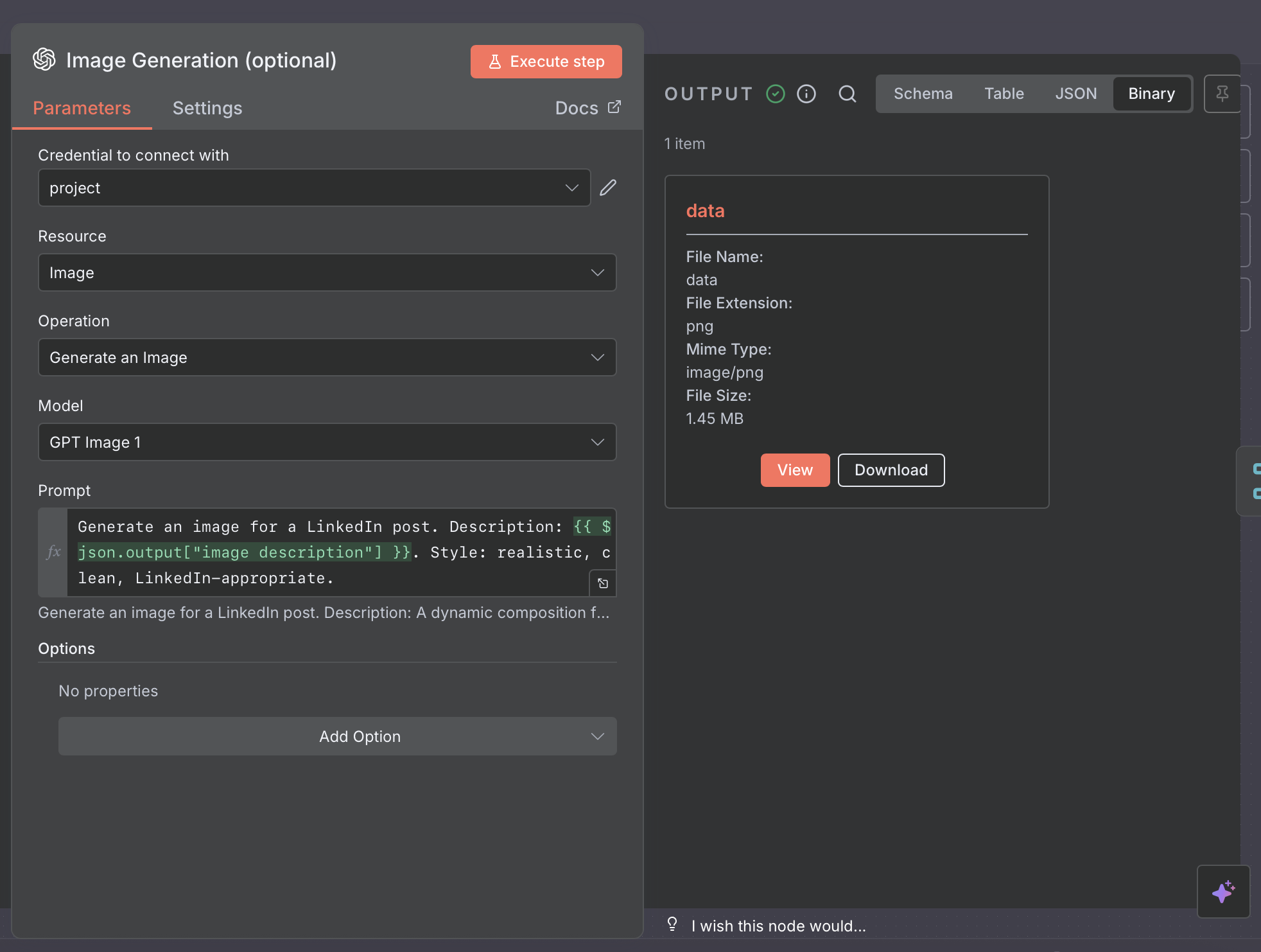

Binary data holds files that move across the execution locally. And that file is shown in a different menu (refer to image)
If you are hoping to receive the image from the OpenAI image generation node, it won’t be shown in the ‘‘Schema’’ menu but on the ‘‘Binary’’ instead under the field name ‘data’ by default. Make sure the OpenAI node outputs binary data first.

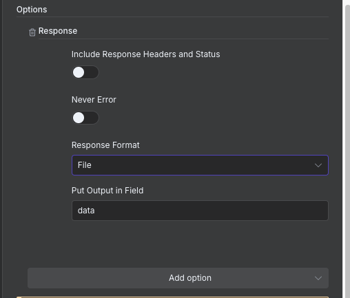

Note: If there is an option in the OpenAI node called ‘Response’ add it and select file response type. Built-in n8n HTTP Request nodes have that option (refer to image)
Yes the Open AI image generation is giving a binary output, see the below image:
somewhere done the flow it is not creating a binary data, or passing it, so the final LinkedIn don’t receive the binary data. Can’t seem to figure it out on how to solve this issue
