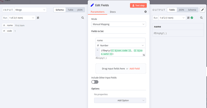

I try to use the ifempty function within an expression but the output is not what I would have expected. I need the value as output but it seems to give me ifempty as well…
Can you tell me what am I’m doing wrong?
This is my workflow

javascript only runs inside of the {{ }} in n8n so your entire expression needs to be inside. Also, methods such as .isEmpty() go after the variable.
So you would get a true or false from .isEmpty() like this: {{ $json.code.isEmpty() }}
If you want to get a value based on that, you can use a ternarry operator like this
{{ $json.code.isEmpty() ? "value if true" : "Value if false" }}
What’s your use case here? If you want to set a default value if “code” doesn’t exist, you can use a much more concise syntax like this {{ $json.code || "default value" }}. The || means or in javascript, if the value to the left is undefined (or falsey in JS), then it will use the value to the right.

What I want is if no data get found with the value from the trigger then It goes to the loop and get another value. So in the set after the merge I want todo if value from loop set is empty then take the value from trigger. Maybe there is also a better way where I can do this but this is what I thought should work.
The workflow had a little wrong in the ifempty since I took first trigger then set. So it should be like this ifEmpty({{ $json.set2 }},{{ $json.code }})
I got it to work but with different code
{{ $json.set2 !== undefined && $json.set2 !== “” ? $json.set2 : $json.code }}
But I think I did your code wrong :smiling_face: yours should have worked too
That definitely works but you can simplify it to:
{{ $json.set2 ? $json.set2 : $json.code }}
or simply it even further with {{ $json.set2 || $json.code }}.
If the code I quoted worked for you then so will both of these if you just copy and paste them. Read more about it by looking up truthy and falsy values, ternary operation, and logical or operator (||)
The $json.set2 ? will automatically return false if it is undefined or “”, so you only need to put the value itself in this case
