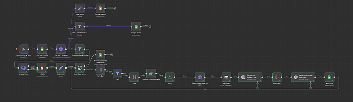

I'm having issues with my loop node
Hello,
This workflow scrapes leads and their website. Then it sends the data into a loop where it scrapes different pages from their main webpage to then feed all that information to an LLM with the purpose of creating a personalized email for each lead. The problem is that I feed X amount of items (in this case 77) into a loop and it only loops twice when it should loop the same amount of items (77). I’ve tried all the settings in the loop node and nothing worked. I just get “the workflow has executed successfully”. I’ve also tried the workflow unpinned and with different scrapped leads, and the loop always stops after the second run.
No error message
(If i paste the workflow the whole page freezes)
  • n8n version: 1.92.2
  • Running n8n via: n8n cloud
  • Operating system: macOS Sequoia v15.5

Got your issue bro let me tell you what the issue is … first see the picture
This is your output right so see that you have used the filter ( if the url starts with “/” then proceed but you have used split node which splits the url and passes them one at a time to the next node. Whne the first url is “/cart” the workflow continues and then the data is processed but when moved to the next node the url starts from “#” which denies the filter and there is no output because the split node only passes one output ( link ) at a time. That is why when there is no output from the filter then there is no further data to run the workflow and the workflow stops without any error. Because when there is no data then the workflow doesnt show any error.
