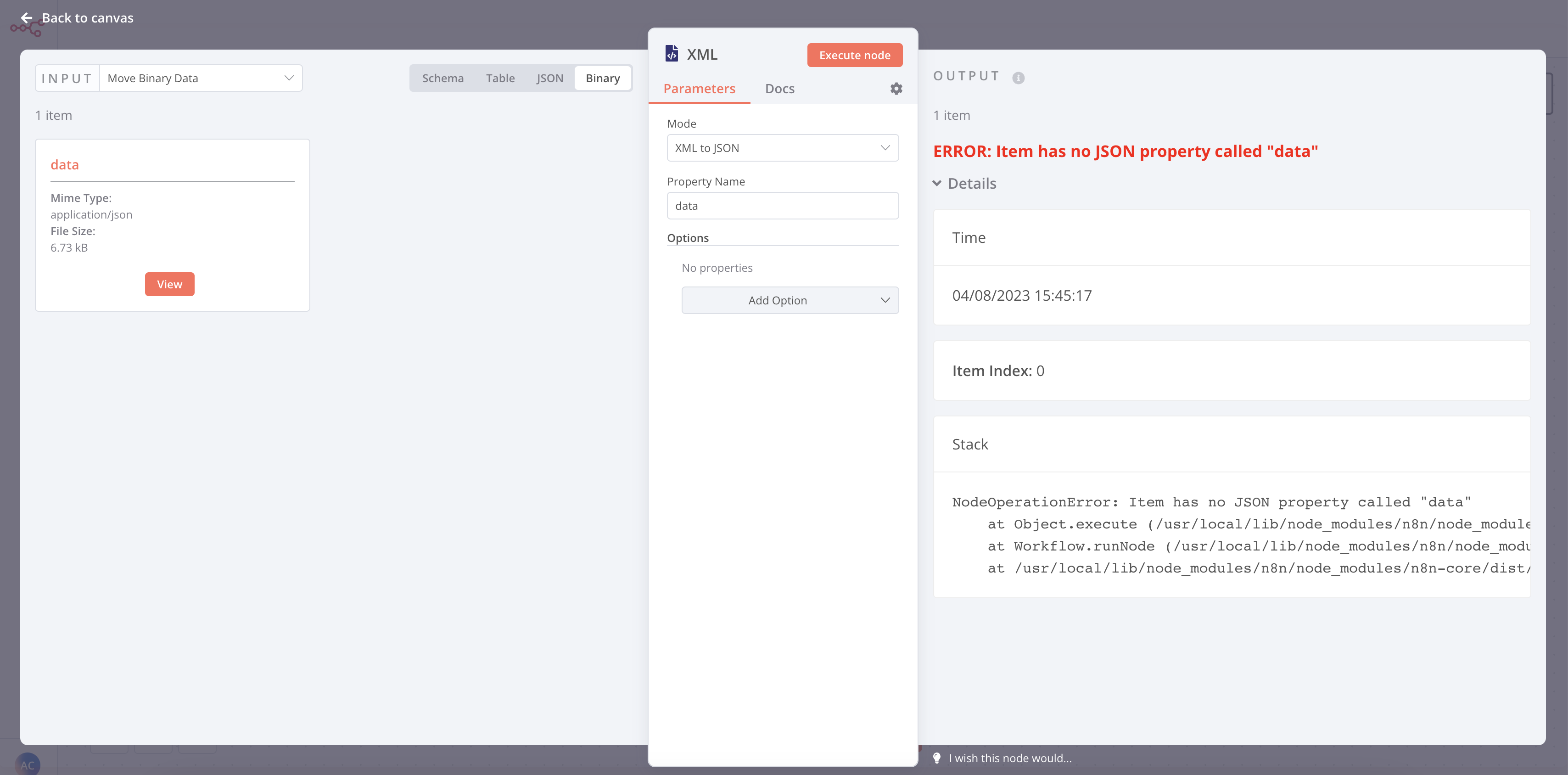

Hi @djangelic, this is what I get as an error.

I think the issue here is that the XML node doesn’t take binary data as an input, Can you share what is in the JSON input?

Hi @djangelic I’ve finally found the solution!!!
It seems that the file wasn’t valid. It was missing some closing tags that I’ve framed in red on the screenshot. I also ticked the ‘Keep Source’ option in the Move Binary Data node, which solved the problem completely. I hope this helps others :slight_smile:
