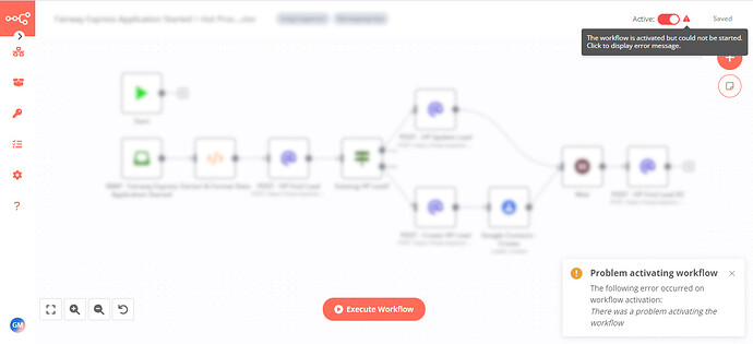

I just noticed that I am now getting an error message stating that one of my workflows with the IMAP Email trigger node is active, but could not be started.
I actually noticed this same error for both workflows a couple of days ago.
