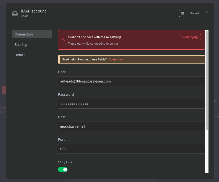

IMAP node is not working properly over self hosted version.
When I am trying to create credentials over IMAP node it not verifiying and it saying connection time out but i have tried to check the connection inside container and used telnet and openssl and its verified and connected.

inside container when I have used OpenSSL for checking connection with imap.titan.email its says connected and dnslookup also seems to be showing fine.

Yes i forget to mention its working just fine with cloud version.
yes on my instances nginx is the reverse proxy but on my local i have only forwarded port via ngrok to make it https.
