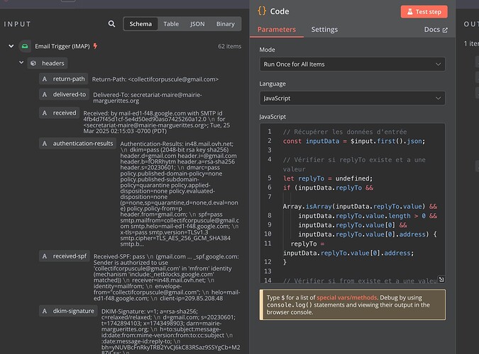

I’m connecting an IMAP trigger on an email address. But I have an issue, when I set for instance 20 emails to unread, then they are taken into account as a single call by the IMAP trigger, resulting in 20 items in the imap call.
The issue is that I then want to manage each email independently, but only the first one is taken into account. How to manage this?

Short answer:
Because you tell it so by using $input.first()
Although it’s not the only issue here.
Longer answer:
The problem is that the Code node is not tuned properly.
You need to change its mode to Run once for each item and replace all instances of $input.first().json to $json
Its absolutely possible to achieve the same objective using Run once for all items mode. But then you’d need to pick all items using $input.all() and map each inbound item yourself.
FYI, $input.first() gives you access ony to the first item of all.
I recommed to read through docs (Data | n8n Docs and its subpages) to better understand the n8n peculiar data structure. It will save you a ton of time.

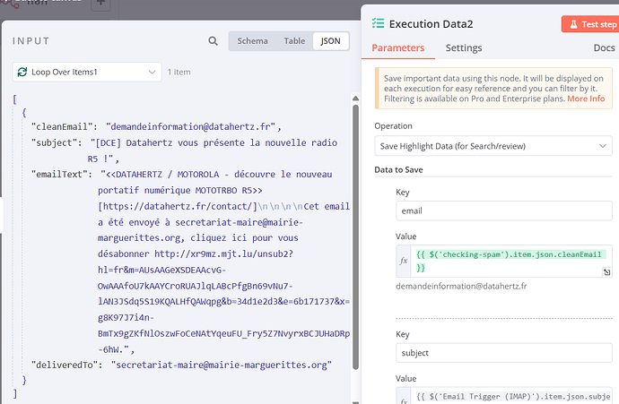

Sure, it’s not the only issue here. I know that first() will just serve the first item, but it seems like if I try on all items, editing the code to get all items instead of the first one, then execution still consider only one item:
Here I have 7 items in checking-spam, but only the first one is saved in Execution Data2… Or maybe I’m not seeing something?

You need to show/look at the output panel on the right to know.
The central panel only shows 1 item to give you a hint if you are on the right track overall.

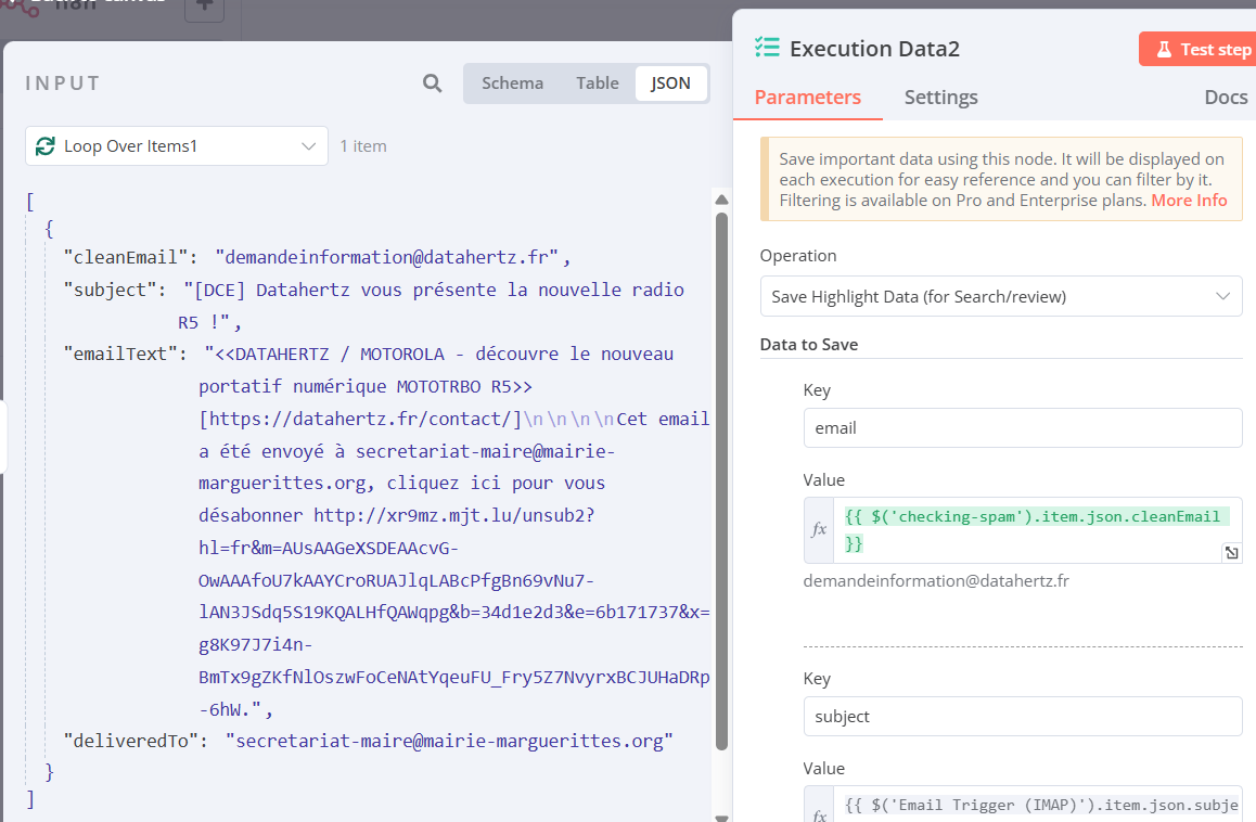

A quick comment: you can edit pinned data.
You do not need to refer distant nodes when you have the very same data at hand.
I mean, $json.fieldName (cleanEmail, subject etc) are absolutely accessible and refer to the record that just arrived from the Loop node (in this case).
Avoid $(nodeName) notation at all cost. It is a source of bugs, a nightmare to debug and understand what’s going on. One change in the code can break all those references.
Instead you need to pass the required (and only objectively required) data down the pipeline explicitly. It sounds like an overhead but this effort will pay when you will want to add functionality to your workflow or someone else will need to look into it and fix anything.
