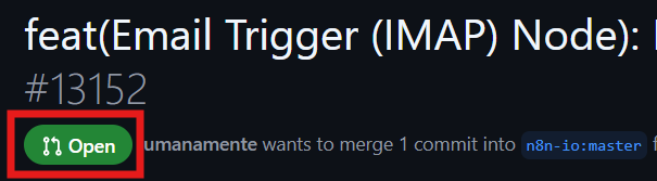

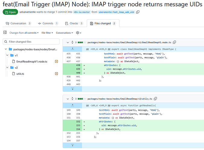

How to get UID email in IMAP node? Here feat(Email Trigger (IMAP) Node): IMAP trigger node returns message UIDs by umanamente · Pull Request #13152 · n8n-io/n8n · GitHub they write that you can do this. But I don’t understand how to do this? I don’t have an attributes column with UID data.

hello @koordinator7
The PR is not yet implemented. It’s still open
Thanks for the answer @ barn4k. What is PR? And how to find out when it will be done. In the screenshot there is already a UID.

The feature you’re looking for (email UIDs in IMAP trigger) isn’t released yet - the pull request (#13152) is still open and pending merge.
