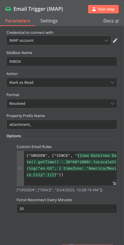

Workflow trigger

If you want the workflow to trigger based on a time window (e.g., processing all emails received in the last 5 minutes), you’ll need to create a custom rule.
This way, instead of relying on the individual IMAP trigger, you’ll capture all unread emails within a given time frame, preventing any from being missed.
Thank you, @merarisosa - I’ve implemented almost the same formula but lowered the time to 2 mins:
["UNSEEN", ["SINCE", "{{new Date(new Date().getTime() - 2*60*1000).toLocaleString('en-US', {timeZone: 'America/Mexico_City' })}}"]]
