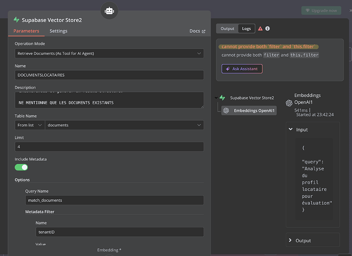

I’m integrating Supabase with N8N to perform vector searches on pgvector-stored documents. My SQL function works fine in Supabase, but the JSONB metadata filter doesn’t work when called from N8N.
I tried everything, it seems like another filter ils passed through in the background creating a conflict ?

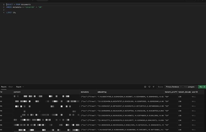

The same filter working well in sql directly in supabase:

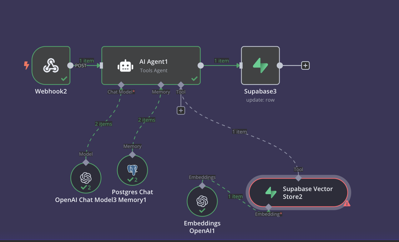

I noticed also that it works as intended when I do the same but in a node “Retrieve documents As vector store for chain tools” but when it’s “Retrieve documents as tool for AI Agent” the presence of a metadata filter causes an error

this other type are accepting filters, but “As Tool For AI Agent” Give this sad message

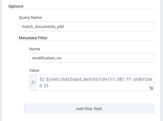

Would this kind of filter help?

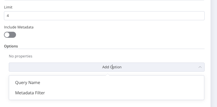

When you use Operation Mode : Retrieve Documents As Tool for AI Agent we only have those options :
