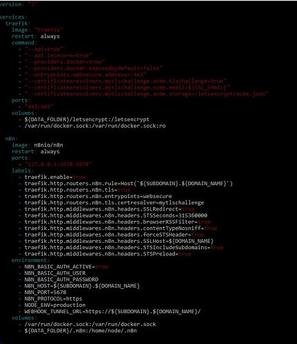

Hello @frankl1, what does look your docker-compose.yml?
Hello @Elpatii
This is my docker-compose.yml:

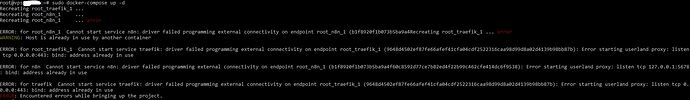

This is the exact error I have:
Hello @frankl1, it seems that you have other containers running and using these ports.
If you list your running/stopped containers (sudo docker ps), do you have something?

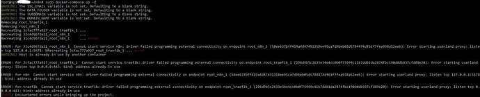

I try to stop and restart my docker compose with this commands:
sudo docker-compose stop
then
sudo docker-compose up -d
I have this error:

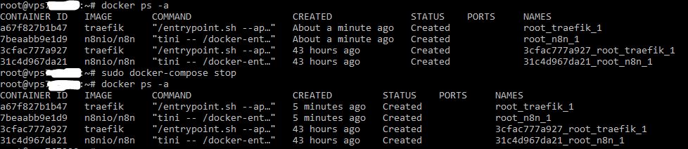

I try sudo docker ps:
n8n2
Strange, because you see in the CLI that docker-compose add the suffix _1 to each container, like if you have already containers created with the name without the suffix.

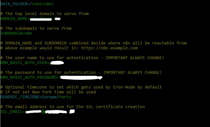

Did you create the .env folder as described here in step 6 which sets this variable?
Hi @jan,
Yes, I have my .env file:
n8n 4
And it is here:
