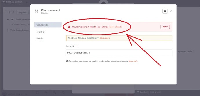

In n8n I can't connect ollama chat model. What should I do?
When I select ollama model chat, in the test to connect’ I get following error with “http://localhost:11434” address. What should I do? Also servis is run and OK and its API is working without n8n.
Couldn’t connect with this setting

@Franz , I do that but it doesn’t work. Can this photo help?

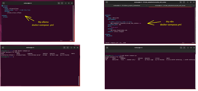

When http://host.docker.internal:11434 does not work, you can try to add extra_hosts to your docker compose file.
This is probably only necessary when Docker is running on Linux Machines.
services:
  n8n:
    image: n8nio/n8n
    environment:
        - N8N_COMMUNITY_PACKAGES_ALLOW_MODE_USAGE=true
    container_name: n8n
    ports:
      - 5678:5678
    columes:
      - n8n_data:/home/node/.n8n
    restart: unless-stopped
    extra_hosts:
      - "host.docker.internal:host-gateway"
volumes:
  n8n_data:
If it doesn’t work you can also set network_mode: host in your n8n docker compose file and change the url to http://localhost:11434 or `http://127.0.0.1:11434.
My recommendation is to run both services in a single Docker Compose setup. This way, you can use http://ollama:11434.
