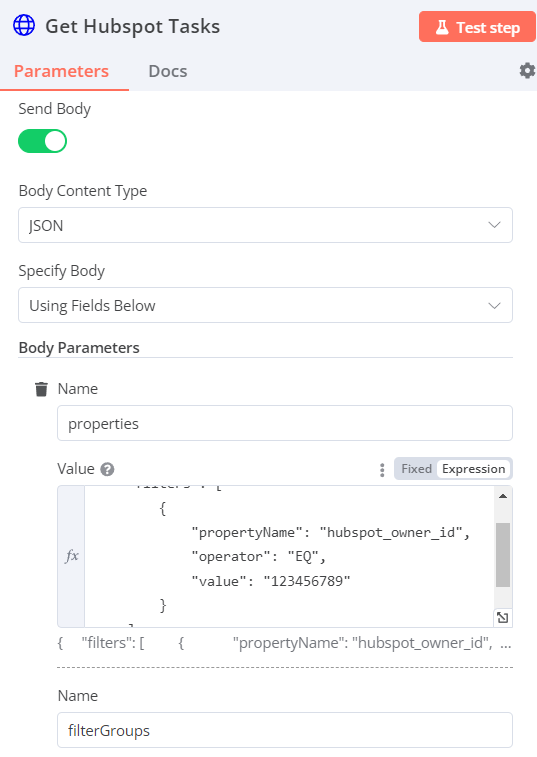

Include $json variable in Body String for HTTP node
I want to make the following code dynamic:
FROM:
    "filters": [
            "propertyName": "hubspot_owner_id",
            "operator": "EQ",
            "value": "49383796"
TO:
    "filters": [
            "operator": "EQ",
            "value": "{{ $json["results"]["id"] }}"
I tried both double quotes and single quotes. ie: {{ $json[‘results’][‘id’] }}
I need this because I have other Body Parameters to populate like “after” and “limit”.
Needs authentication to work so I can’t share.
  • n8n version: 1.34.0
  • Operating system: Ubuntu Linux 22.04?
@tim.berneman , so, what is the problem? Single quotes or {{ $json.results.id }} should be just fine.
Of cause you can share and you should. We do not need to connect but we need to see your configuration.
Yet, again, you haven’t explain what problem you have encountered. Any error message?
The problem is it doesn’t do the substitution
of {{ $json[“results”][“id”] }}
to 12345678
The Error is “[invalid syntax]”
Thanks for you prompt and courteous reply.
The dropdown option “Using Fields Below” means you should enter a string there.
You can force it to use a JSON by placing all the content inside the double brackets {{ <your_json> }} or you should use the JSON Body type and specify the whole JSON there
That is why we need to see your workflow configuration. For example, here’s no syntax error.

It’s has nested JSON structure. Therefore, I would suggest engaging “Using JSON” option (instead of “Using Fields Below”) as the body of the request. For example,
Ya, that’s what I ended up doing. I switched to “Using JSON” and did it as a whole block.
Thanks for your help!
