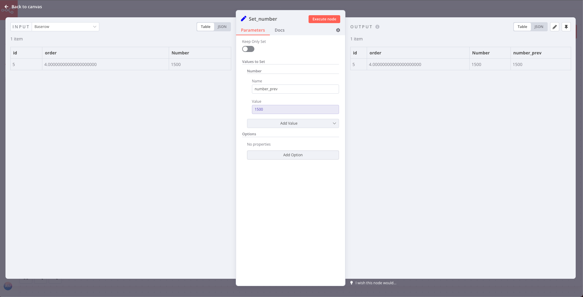

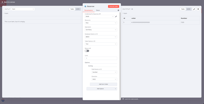

Hi @Gabriele_Bracciali,
To increment in each execution a value of +500 you should set up a workflow that saves that value in some kind of database or a simple Google Sheets file to be able to retrieve it in each execution.
In the following sequence, you bring the last value of a table in Baserow, add the value 500 and save it again in the same table, so that in the next execution the workflow will start at 500,1000,1500, etc.
:wink:

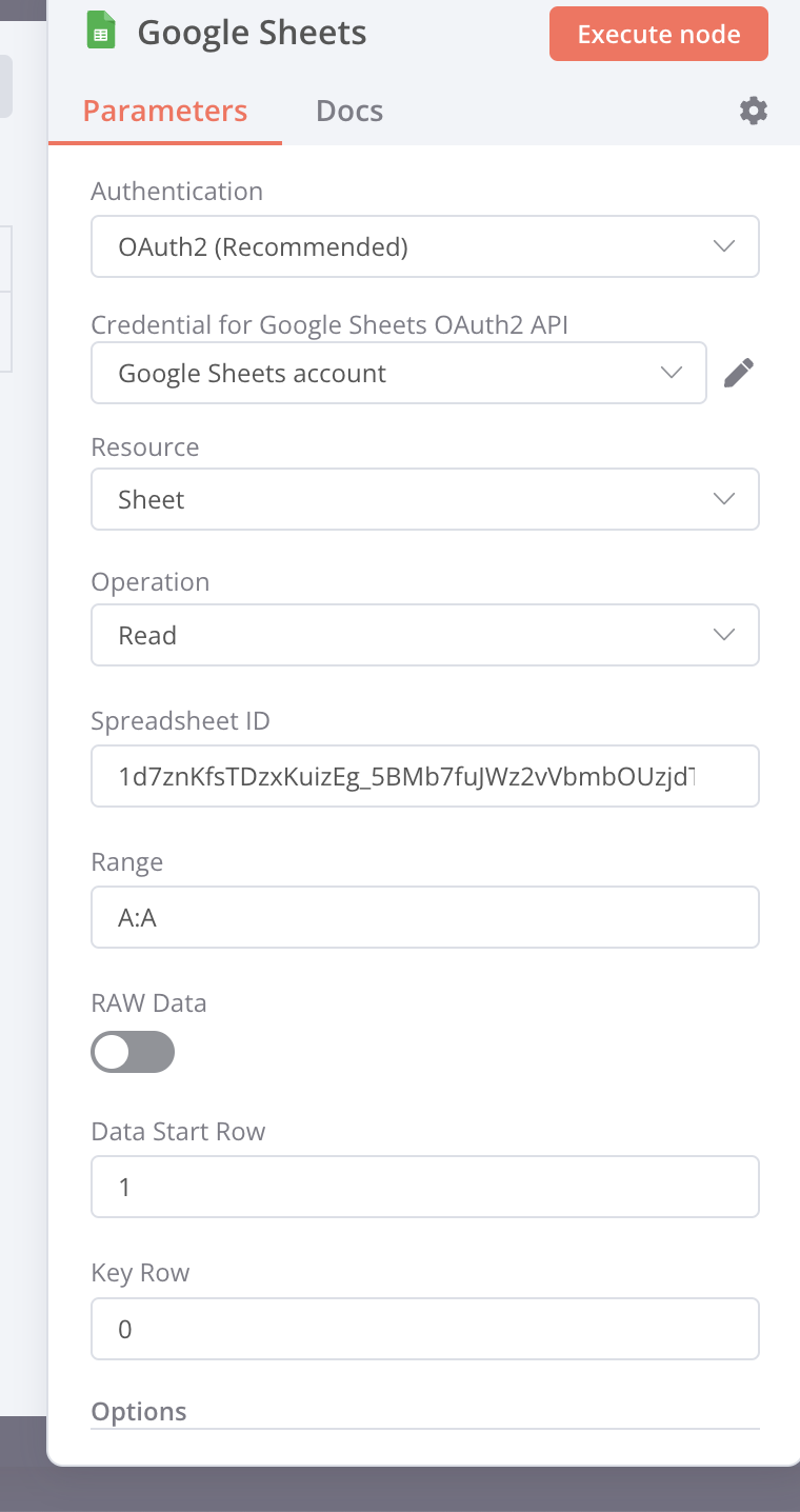

Same operation in Google Sheets…

okay nice, i’ve tried but the first google sheet node doesn’t work, it return me an empty item
Have you defined the column name and assigned a first value, e.g. 0?
Screenshot 2022-10-07 at 17.32.49
Define the column name in cell A1, and then assign the first value 0 in cell A2.
done it, okay now the function return me this
edit:
it was my problem, cause i was using another “Item Lists” in the workflow @martinhache
What is the name of the previous Item list node?
It was Item List, and when i past your nodes, the Item list takes the name “Item List2” , so i’ve change the name in the function, and it’s working
