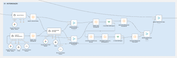

I’m trying to create a high-quality script automation and I’d like to follow this logic: create the script > send it to the validator > if true, follow the flow > if false > refiner. I think the problem is that I want to validate the text twice to have high quality. I’ve already done SEVERAL tests, inserting if, switch, etc., but either it gives an error if the parser fails or the code to control the number of refinements simply doesn’t work and the system gets stuck in an infinite loop.

Hey can you share a screenshot of your workflow and the actual error message youre getting? Hard to tell whats going wrong without seeing how the nodes are connected and what the output parser is returning.
Sure, this is the current screenshot before the credits run out.
You’ll see the error in the script agent right away, because it happened after the daily credits had finished.
I also tried something like that with the parsers in the agents, either the output parsers give an error, or the circuit gets stuck in an infinite loop.
In both cases, the same obstacle persisted.
Actually, I already have some code with that JavaScript, which is intended to control the refinements; I believe it does the counting you mentioned. And the model I’m using in the validator agent is gemini-2.5-flash.

I think the issue is related to how the AI agents output the data as you are straightaway using that with a merge, consider trying the Auto Fix Output Parser i know it is deprecated but you can still use. I think you need to work on your overall flow too, it is a bit hard to debug with all the code nodes, you can try using a Set Fields node also. (share your JSON)
Your counter code got cut off right at the return statement — can you share the full thing? If that return isnt actually sending back reachedlimit and nextrefinement properly the loop would never know when to stop. Also if you can export and share the workflow JSON that would make it way easier to debug than screenshots.
