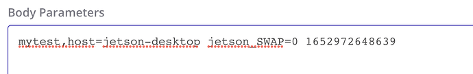

Just tried last night, I went crazy trying to make it work, seems that not even with a normal HTTP Request I can make it work… Im on 0.176.0.
Can someone shared a workflow that actually works using influxdb2? thanks :slight_smile:

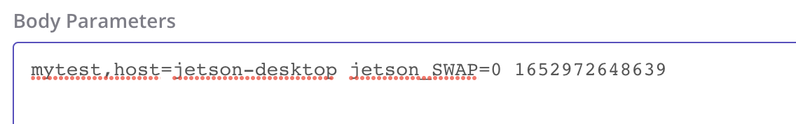

Bad timestamp looks like when sending data using line protocol for influxdb the request is attaching stuff at the end or not sending the body properly. Probably is to do with the string scaping you doing before sending it.
I have tested in postman curl and other ways and works perfectly, issue is in http request n8n. Hopefully gets solved soon.

I can’t actually see where the timestamp is being set in that workflow :thinking: I will get a local instance of Influx set up and see if I can work it out.
Yes feel free to call me if you like, the request is sent here
What happens if you try to send the data as a binary object does that work? I found if I use a set node then convert to binary and send that I get a 204 response back from Influx which looks like it could be a good thing but I don’t see it in the Influx interface which could be because I am using cloud I am not sure. I did find that Postman does the same thing though so it could be a temporary solution until we (or someone else) makes a node.
