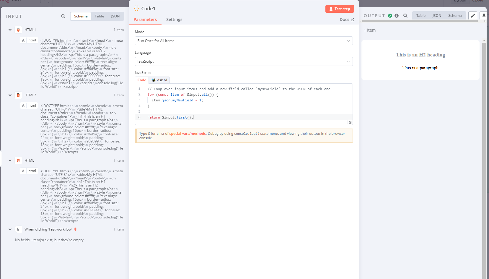

Input.all() but for 2 nodes back and so on
is there a way to get the $input.all() but for the 3 nodes back node and so on?

this is a sample, but assume the inputs for all previous node is a json or array with many variables. I wanted to add all inputs from all 3 previous nodes in different variables in code but i need the .all(). is there a way to .all() but for first node, second node, etc. ?
$(“NODENAME”).all()
