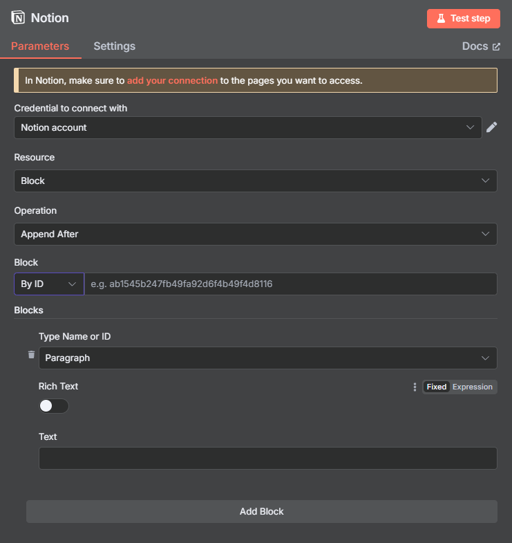

you can use the Block - Append After operation for that. You will need to get the page blocks to find the proper block ID and then use it to append a block after it.
Your top level block id is the page id, which you always has on a page

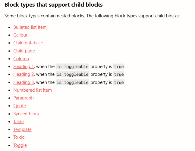

I tried this solution but I have the issue ‘Block does not support children.’
According to the API, adding a child to the heading 2 block should be possible.

I am able to append a block to Heading when is a toggle

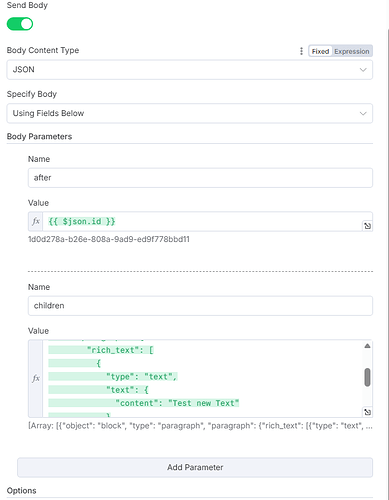

Well… you can try an update page method to rewrite the content, but you will need an HTTP node with creds from the notion, as the notion node doesn’t have that method. I can’t advice how the request will be, as the docs are not very clear about the properties section

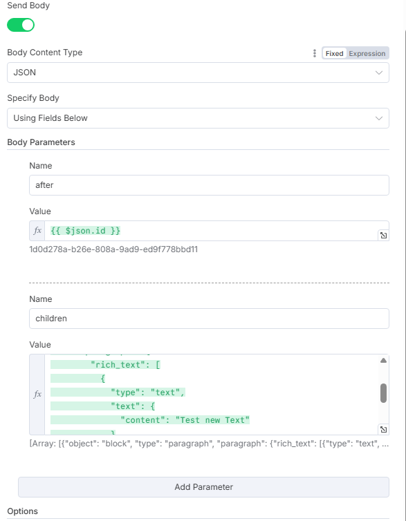

I found the answer using the documentation !
We can the use the Http Requestion :
PATCH
https://api.notion.com/v1/blocks/{{ $json.parent_id }}/children
Example for the children :
      "object": "block",
      "type": "paragraph",
      "paragraph": {
        "rich_text": [
            "type": "text",
            "text": {
              "content": "Test new Text"
Only works if we are not using toggle
