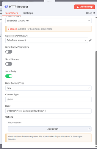

Trying To Insert A campaign record to salesforce via HTTP, not getting an error but no record is created,
this is my setting:
Method
POST
URL
https://(HIDDEN ON PURPOSE..) .force.com/services/data/v58.0/sobjects/Campaign/
Authentication
Predefined Credential Type
Credential Type
Salesforce OAuth2 API
2 scopes available for Salesforce credentials
Salesforce account
Send Query Parameters
Send Headers
Specify Headers
Using Fields Below
Header Parameters
Name
Content-Type
Value
application/json
Send Body
Body Content Type
Raw
Content Type
JSON
Body
{ “Name”: “Test Campaign Raw Body” }
Options
any ideas?

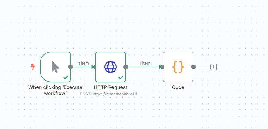

i tried " [ “Name”: “Test Campaign Raw Body” ]" , and my connection is stable since i tried a get and it worked, the HTTP status code just returns NA,
what can i do next?
Hello!
Try to use:
{ "Name": "Test Campaign Raw Body" }
With {} and not “[” “]”
Avoid smart quotes (“ / ”), they’ll silently break the request.

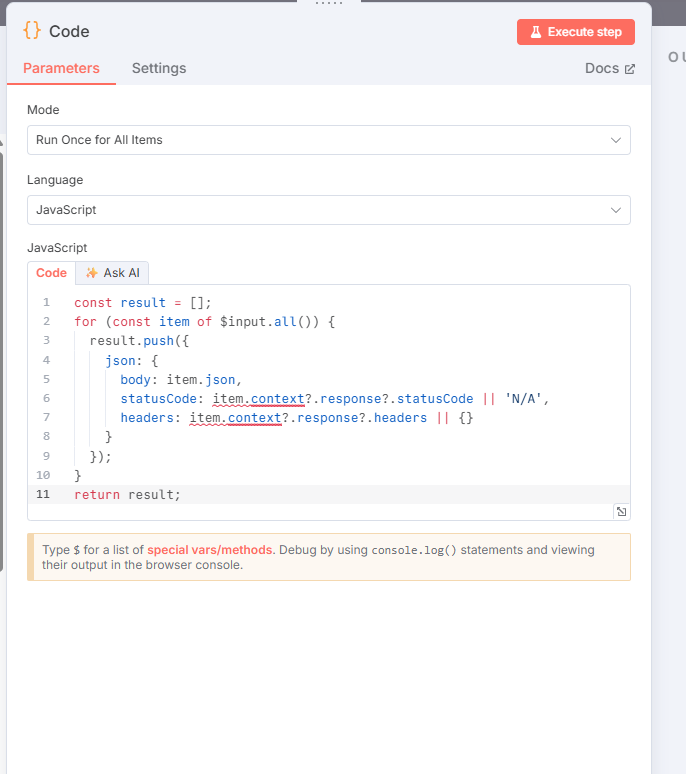

the code you gave me through an error and the ai in the platform offered this instead:
return $input.all().map(item => ({
json: {
body: item.json,
statusCode: item.context?.response?.statusCode ?? ‘N/A’,
headers: item.context?.response?.headers ?? {}
what are your thoughts? still not inserting..
