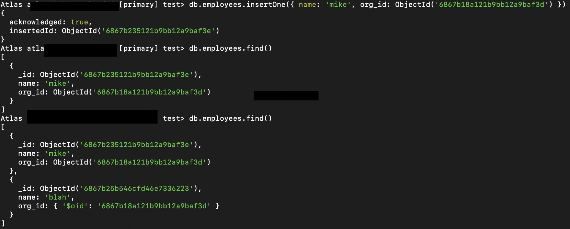

test> db.employees.insertOne({ name: 'mike', org_id: ObjectId('6867b18a121b9bb12a9baf3d') })
  acknowledged: true,
  insertedId: ObjectId('6867b235121b9bb12a9baf3e')
test> db.employees.find()
    _id: ObjectId('6867b235121b9bb12a9baf3e'),
... after running flow ...
    _id: ObjectId('6867b25b546cfd46e7336223'),
    org_id: { '$oid': '6867b18a121b9bb12a9baf3d' }
How do I this inside n8n?

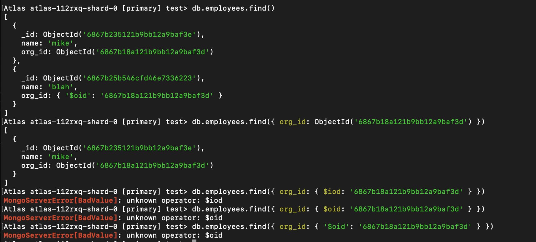

How about inside the mongodb console? Can you share it?
That is the mongodb console

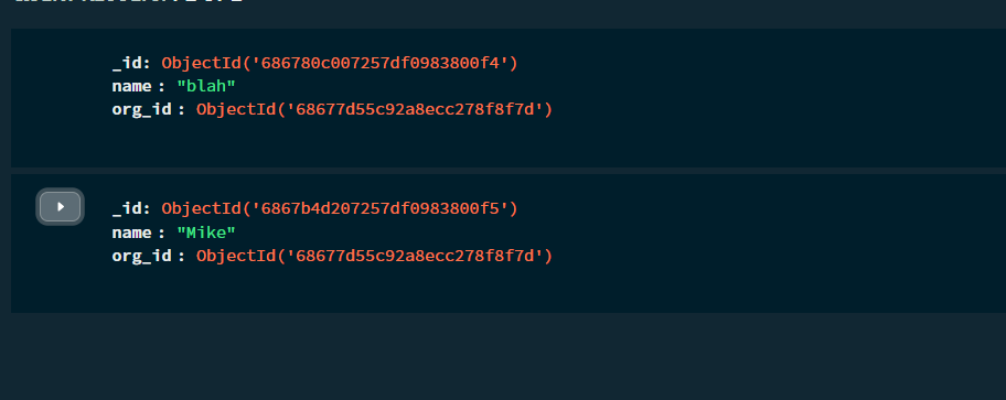

Thanks!
Sorry I mean from MongoDb Website.
Did you try my flow btw?

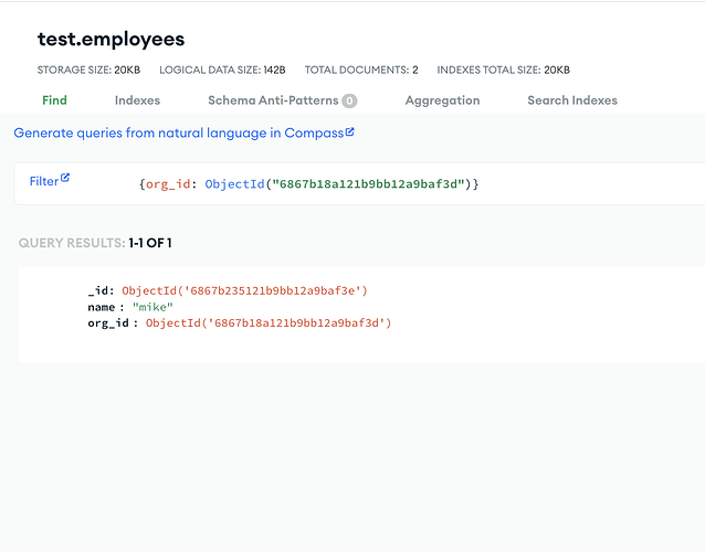

yes tried the flow - that’s how i got to the point i am. thanks!

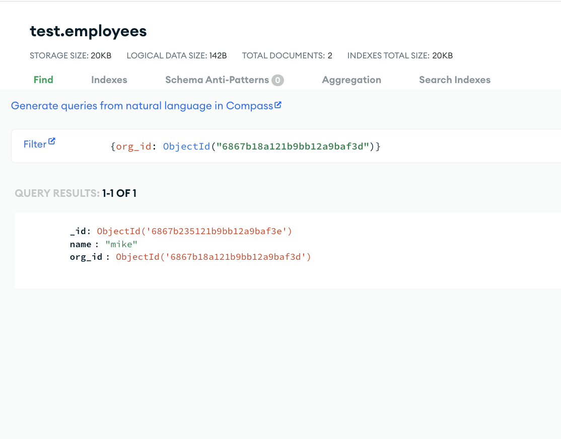

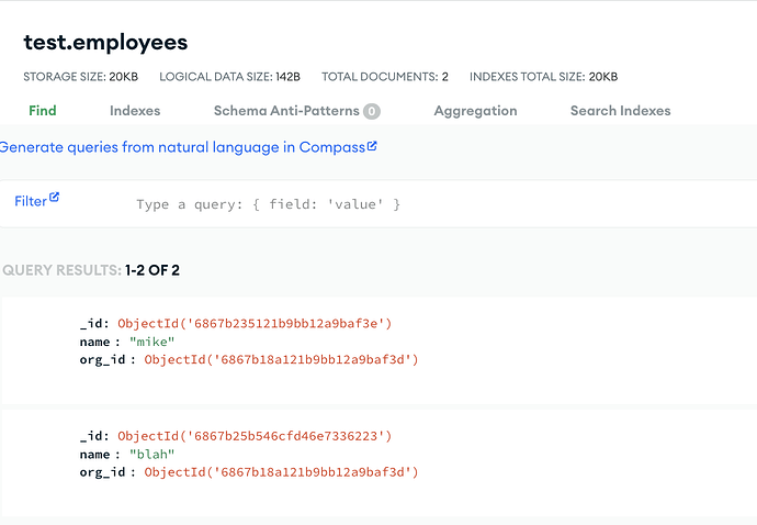

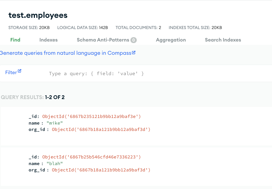

the mongodb site shows both docs having ObjectID
but querying by org_id returns only the non $oid one
and i can’t query on $oid
I have no idea, trying unlimited time with no results. Same as you.
