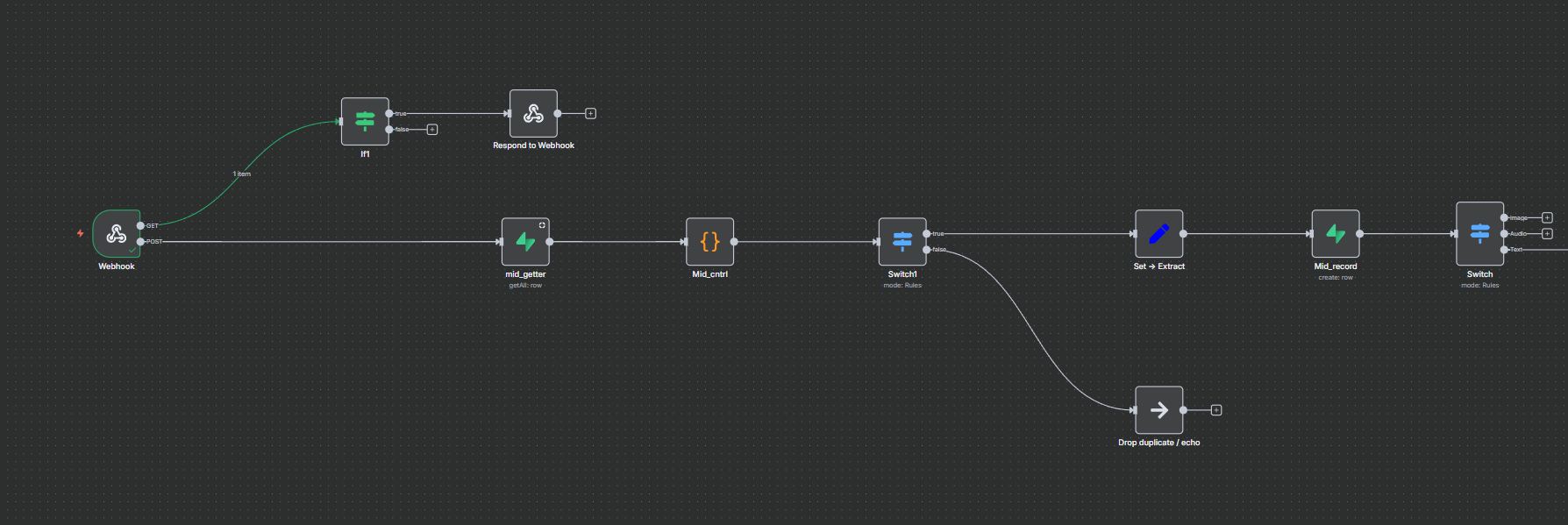

I set up a DM automation for Instagram.
I used a chat trigger when creating the agent structure. My agent structure works flawlessly and exactly as I want it to.
However, the problem started when I tried to connect it to Instagram.
I am not using third-party software.
I connected the Instagram account to the workflow via webhook.
After completing the testing phases, I went live with the app via Facebook and activated the DM automation.

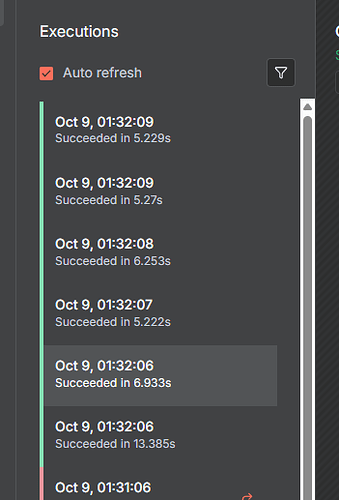

Whenever I send a message to Instagram, the webhook triggers multiple times.
I just can’t seem to figure this out.

I tried external solutions myself. Each message generates a “mid” number, and even if I try to filter them, I think the mid values change because the webhook triggers the same message multiple times, but I’m not sure.

hello @AtillaOzturk
Check the payload from different executions and remove the duplicates with the Remove Duplicates node.
Maybe Facebook resends the payload if it didn’t receive a 200 response.

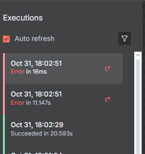

i have same problem maybe litle diffrent. 1 succsess 2 fail
if u find solution pls share whit me.
atilla hocam sanırım çözdüm. sorun aslında instagram 2-3 kere mesaj göndermiyor. çıkan output tekrar giriyor. o nasıl oluyor onu çözemedim ama ilk gelen mesajda is_echo=true diye bir veri var mı onu kontrol et ve engelle. birde boş bir şekilde kendini tekrar tetikliyor boş olduğu için de hata veriyor onu çözemedim
