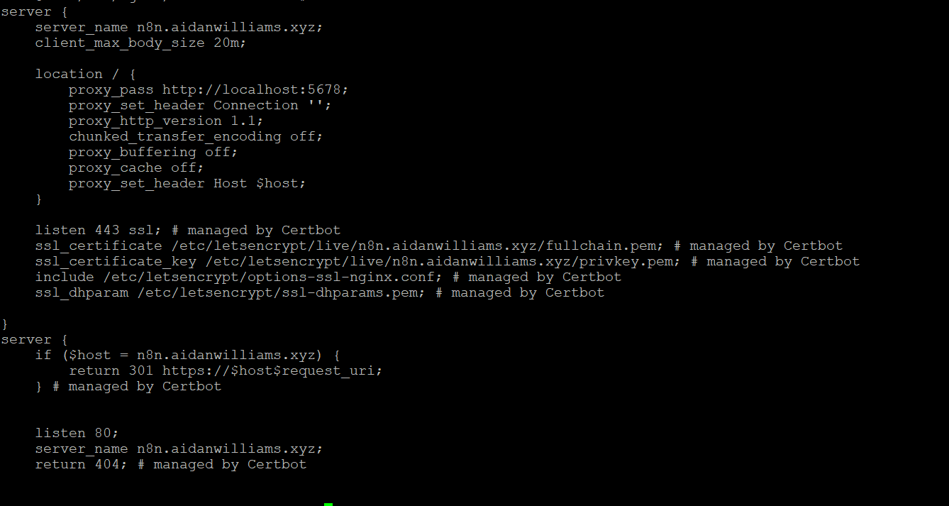

So At the end it should look like this?
    server_name n8n.aidanwilliams.xyz;
    client_max_body_size 20m;
    location / {
        proxy_pass http://localhost:5678;
        proxy_set_header Connection '';
        proxy_http_version 1.1;
        chunked_transfer_encoding off;
        proxy_buffering off;
        proxy_cache off;
        proxy_set_header Host $host;
        # Dynamic Headers for WebSocket Support
        proxy_set_header Upgrade $http_upgrade;
        proxy_set_header Connection $connection_upgrade;
        # Standard Proxy Headers
    listen 443 ssl; # managed by Certbot
    ssl_certificate /etc/letsencrypt/live/n8n.aidanwilliams.xyz/fullchain.pem; # managed by Certbot
    ssl_certificate_key /etc/letsencrypt/live/n8n.aidanwilliams.xyz/privkey.pem; # managed by Certbot
    include /etc/letsencrypt/options-ssl-nginx.conf; # managed by Certbot
    ssl_dhparam /etc/letsencrypt/ssl-dhparams.pem; # managed by Certbot
        proxy_cache off;
        # Forwarding Headers
        proxy_set_header X-Forwarded-For $proxy_add_x_forwarded_for;
        proxy_set_header X-Forwarded-Proto $scheme;
        proxy_set_header X-Forwarded-Host $host;
        proxy_set_header X-Forwarded-Port $server_port;
map $http_upgrade $connection_upgrade {
    default upgrade;
    ''      close;
server {
server {
    if ($host = n8n.aidanwilliams.xyz) {
        return 301 https://$host$request_uri;
    } # managed by Certbot
    listen 80;
    return 404; # managed by Certbot
Hi,
Maybe…This is my file as a public gist. You can compare against it. Make sure to restart nginx:
Khem
