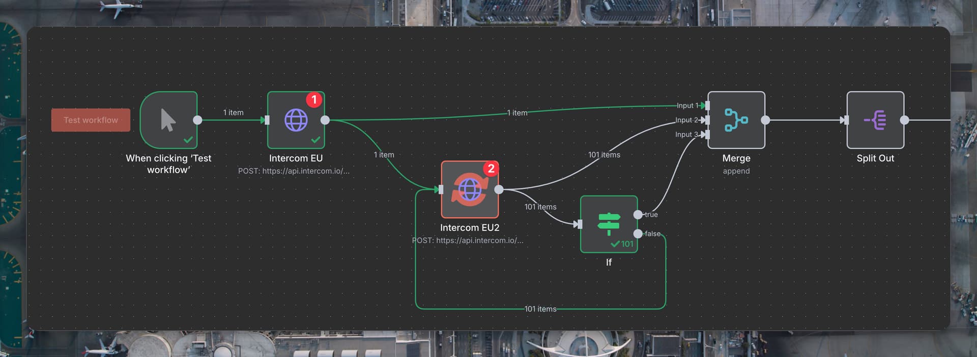

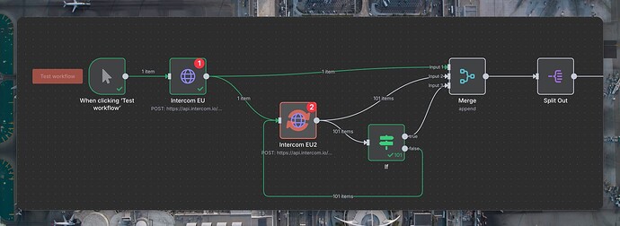

Has the same problem with Intercom.
tried to use pagination.starting_after in node options with no luck.
Try to use workaraund with IF + Merge nodes to collect all items.
Node 1: w/o starting_after in Body
Node2: with starting_after and value is pointed to Node 1 {{ $json.pages.next.starting_after }}
If node used for checking “If there exist next.starting_after”.
Hope this helps, but speed of this solution is very sad… Even with 150 items per request.
