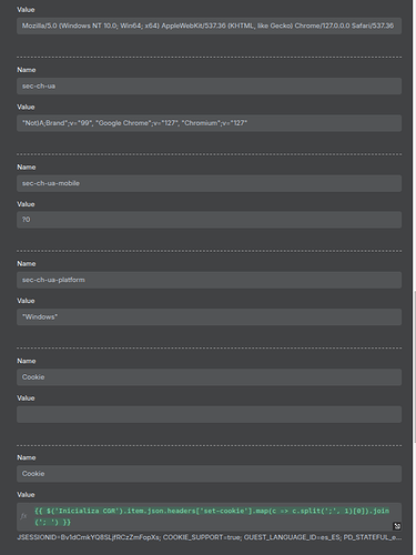

Hey @fermaf
Are you calling an official API or just crawling?
Sometimes you need to set headers like User-Agent, Origin, and Referer to make the request look more like it’s coming from a real user…
full header as a real user…
by the way, it does not metters, The request does not arrive destination, it’s a local problem.
