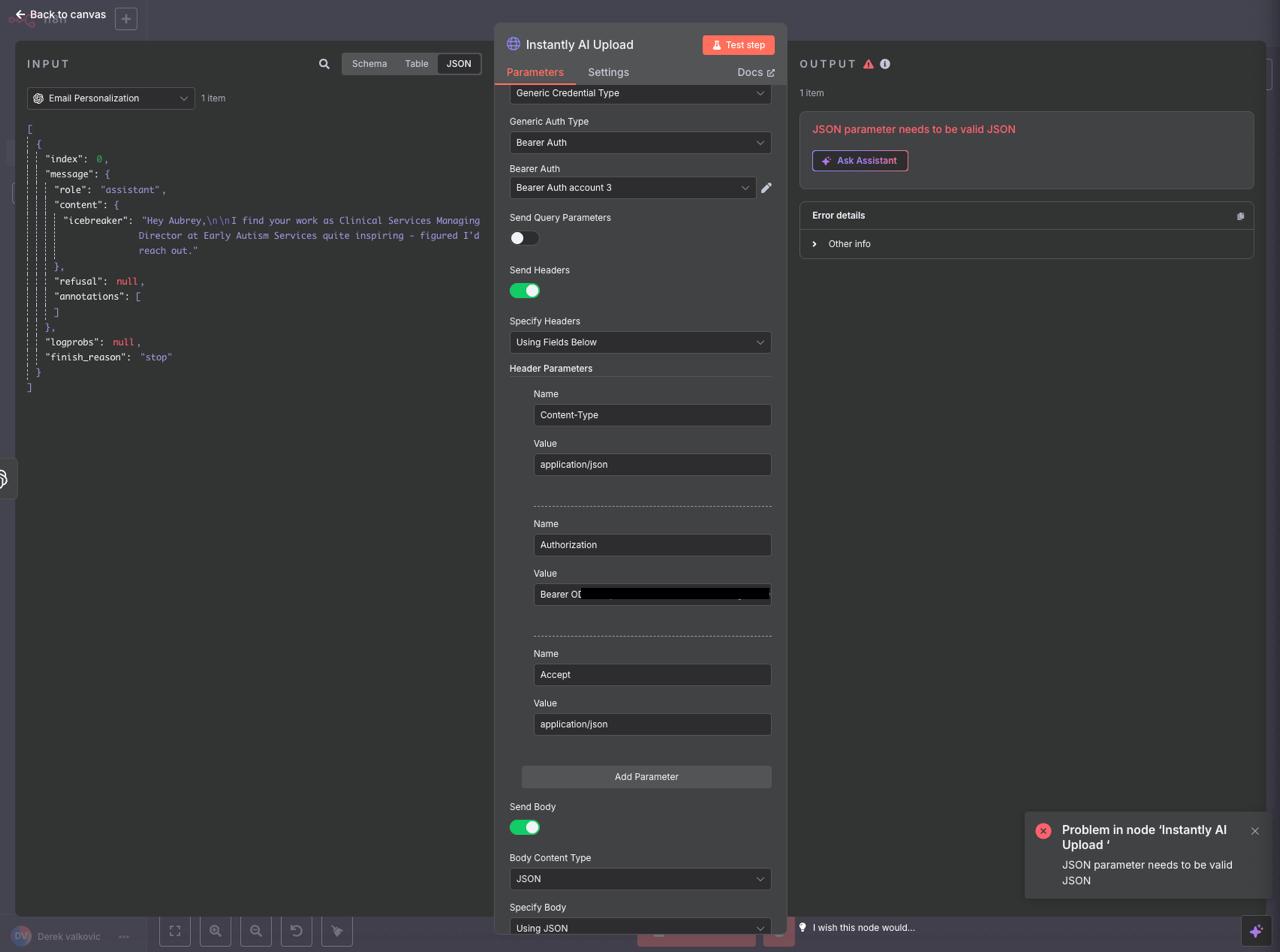

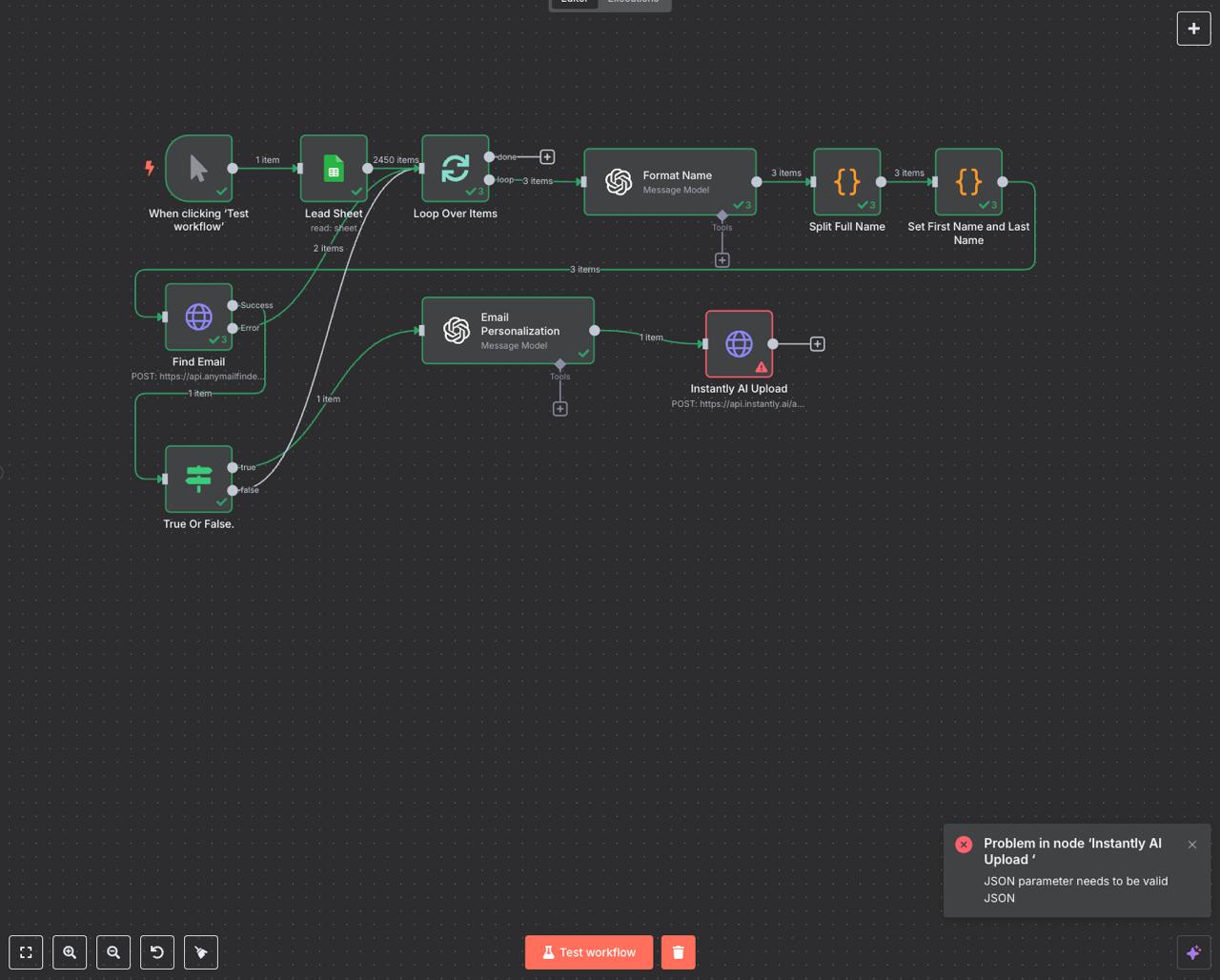

I am attempting to create and Email personalizer and upload into InstantlyAI.
My issue is in my HTTP Module going to InstantlyAI, i keep getting an “JSON parameter needs to be valid JSON”. The only Module I do not have set as “send Json Output” is my “Format Name Agent”, I have toggled this to send json, then it effects the rest of my Flow. I have left it as it (not sending json from this module). As I have investigated I have ran my payload through an Regex101 Test, it is telling me that my “campaign: Campaign ID” is what could be breaking my Json structure. I know it is not, but my main question would be, if N8N is Java Script essentially (Wrapping/Replacing) in JSON, why would this cause my issue if the campaign ID is hardcoded? I could be way off, but this is Day 2 of troubleshooting and I am running out of resources.
As for my HTTP Module, as a last minute attempt, I have added an Header to “Accept - application/json” I have tried with and with out this header and still have failed. I have also cross referenced all the names of the nodes to match the properties that have been added to my payload. Any Ideas?

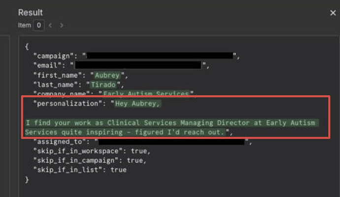

Here is not the valid json.

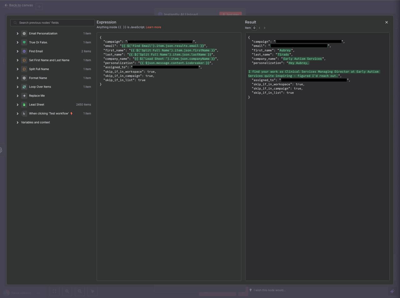

So you can change the expression to
"personalization":{{ $json.message.content.icebreaker.toJsonString() }},
