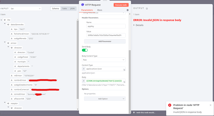

Hey n8n team, thanks in advance for your help,
I’m passing the data generated from Set Node to HTTP Request Node, but I got that error in the image below, I already tried set in the HTTP node in RAW mode with application/json as well as JSON mode with no luck

Sadly I got this error:
It works with the same payload but on Postman, it returns a XML payload if everything is OK

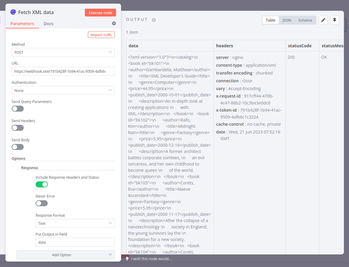

Hi @rodmontgt, I am afraid I can’t reproduce this. Fetching XML data should work fine in general, I tested this using the below workflow:
This is my result:
Is there any chance you can share an example using which your problem can be reproduced? You can for example use a service such as webhook.site to create a dummy API endpoint returning XML data with anything confidential redacted (click the Edit button to mock a response).

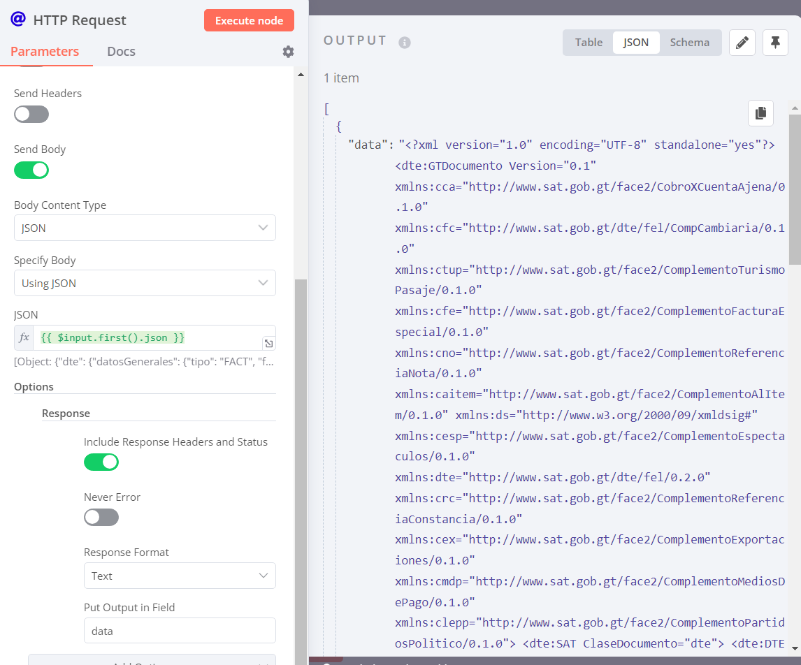

I’m afraid I was sending an incorrect formatted JSON, after fixing the JSON I was able to send it without stringify or parse functions.
In the body field just typed:
{{ $input.first().json }}
and got the XML data as expected
