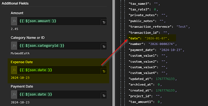

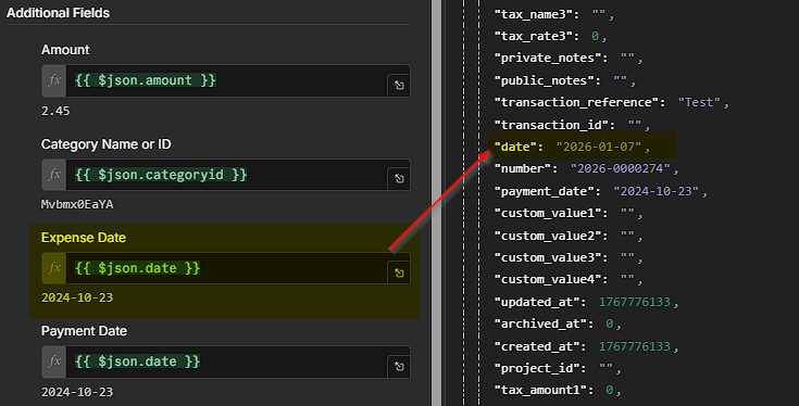

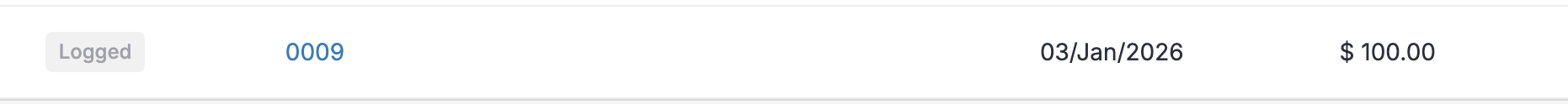

As per screenshot the Expense date in the nodes backend is not sending to date as it is set to expenseDate and not date.

It’s not writing anything to date that’s why its filling in Todays date due to a field-name mismatch between:
  • what Invoice Ninja’s API expects (date, payment_date in Y-m-d), and
  • what the n8n Invoice Ninja node is actually sending (it looks like it’s using expenseDate internally).
Here is the problem should be body.date

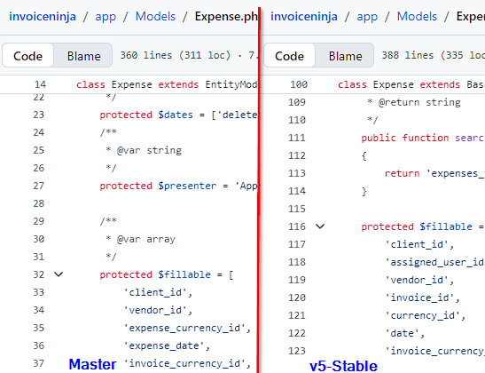

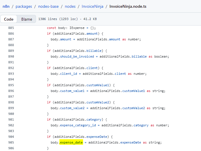

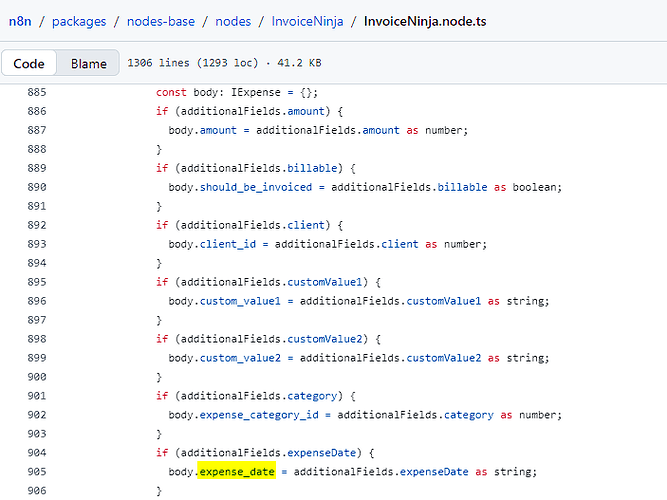

According to the invoice ninja api code for the expense model, it is definitely expecting “exepense_date”
Hi @Wade0,
Ok so I installed invoice ninja locally and tested your claims. While expense_date is the valid and correct field for the expense request, it seems like this is a problem in invoice ninja itself ignoring the expense_date field. You seem to be correct that ‘date’ will set the actual date. I tested this both with the ninja node as well as making a direct http rest call to their API. Same results.
However, when using the http node and setting ‘date’, it seems like invoice ninja does use this as the date.
Thus, I wouldnt call this a bug in n8n’s invoice ninja node, however maybe a suggested enhancement to add the “Date” field as a possible input.
Having all that said, maybe for now, just use the http rest call direct when dealing with Expense creation if you want to set the date. See below example:
And when using the date in the rest http node, it does work:
@Wouter_Nigrini Thanks for the extra insight. I am using the Http node for now.
Ok I see now I am using v5-Stable and expense_date is used in the Master branch.
Guess I’m going to have to wait for that to be pushed to Stable
Thanks all for the help. :+1:
