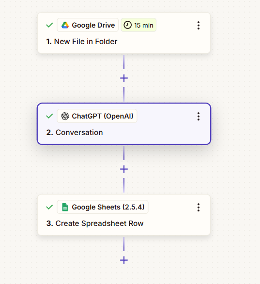

My ChatGPT is able to scan my PDF invoices and then put some info about them in Google Spreadsheet but I don’t know how to use it in N8N. I made such an automation in Zapier but cannot create it in N8N.
Here is my automation in Zapier:
I want to create same functionality in N8N.

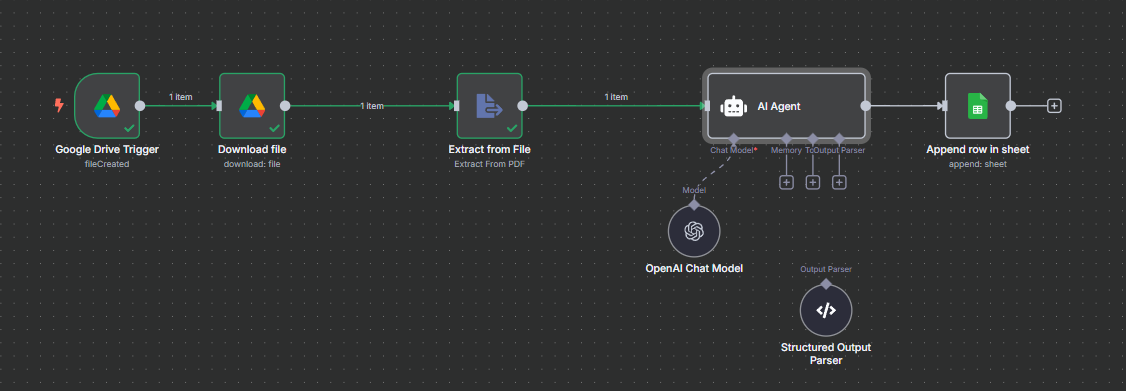

My workflow is here:
Tried to use AI Agent connected with OpenAI Chat Model (latest 4o) and also tried to chat with a model directly but it acts like it can’t scan PDF files - gives me some random invoice output data (invoice number, net value, etc.)

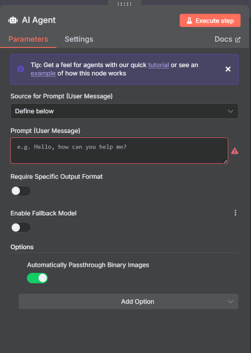

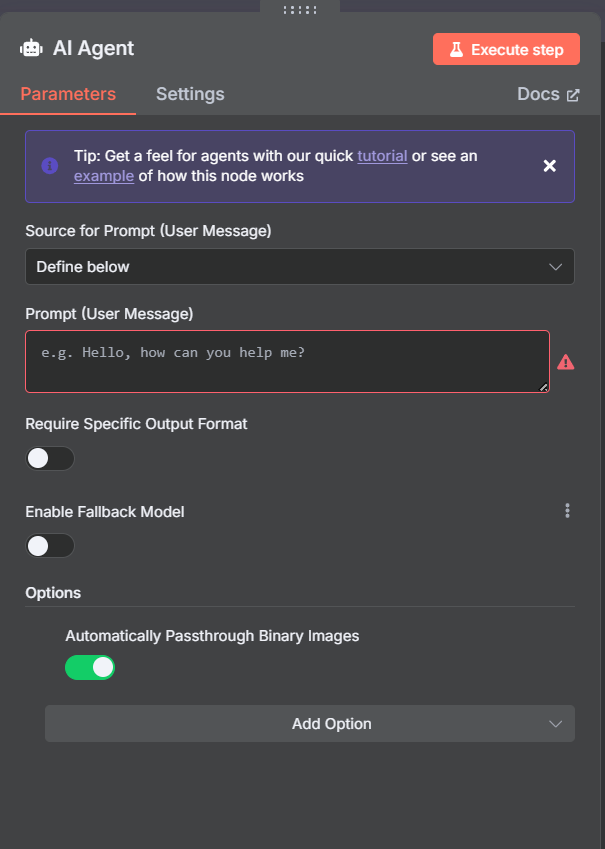

Hi there, i think on the ai agents, theres an option you need to enable first
I believe the option is “Automatically Passthrough Binary Data” try turning tht on
Did you turn on the Automatically Passthrough Binary Images? Cause if you try to do the OCR with image, you can try to activate that option.
Nothing changed.
It still cannot scan proper invoice data.

Try with directly using OpenAI node instead of using AI Agent node
I had to add another step - extract from PDF. Now it works fine.

  1. After the “Download file” node, add a PDF Extract node (community node) if your invoices are native PDFs with selectable text.
  • If that node isn’t available, use a Function node with the pdf-parse package to extract the text.
  1. For scanned/image-based PDFs, use Tesseract OCR (community node) or an HTTP Request node to send the file to an OCR API like:
  • OCR.Space
  • Google Vision OCR
  • AWS Textract
    (You’ll need to send the file as base64 or form-data, depending on API requirements.)
  1. Take the extracted text and pass it to the AI Agent or OpenAI Chat Model like this:
    4.Prompt:*
    "You are reading raw text from an invoice. Extract and return the invoice number, issue date, supplier name, and total amount from the text below:\n\n[PASTE TEXT HERE]"
  2. Use a “Set” node or Structured Output Parser to format the extracted values from the response.
  3. Send that clean data to the “Append row in sheet” node.
The key is: OpenAI in n8n can’t read the PDF itself. You must extract the text or OCR it first, then pass the clean text to the model.
