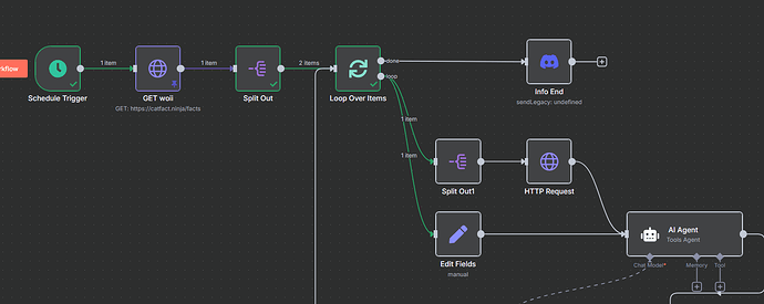

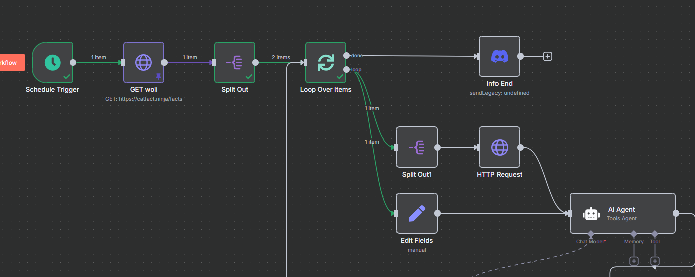

Does the loop over node allow to split into two branches? or is it restricted to one? My initial plan was to do the following workflow:

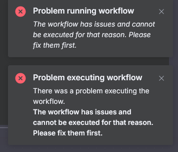

but running either the split node or the edit node will result in an error

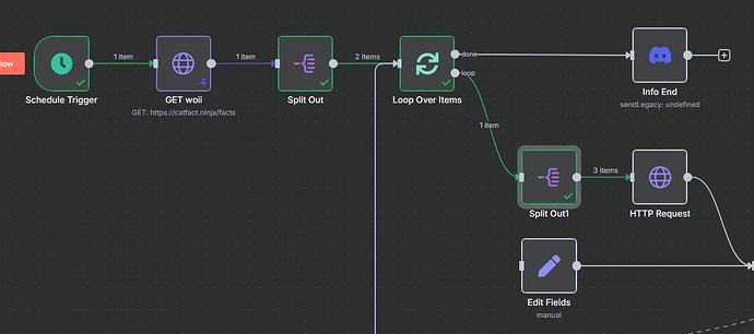

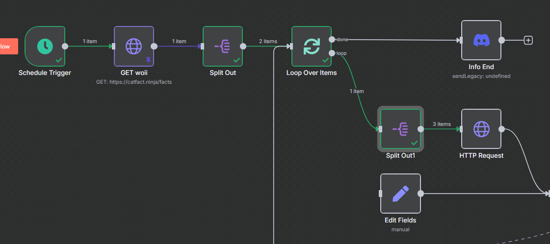

running just the split:

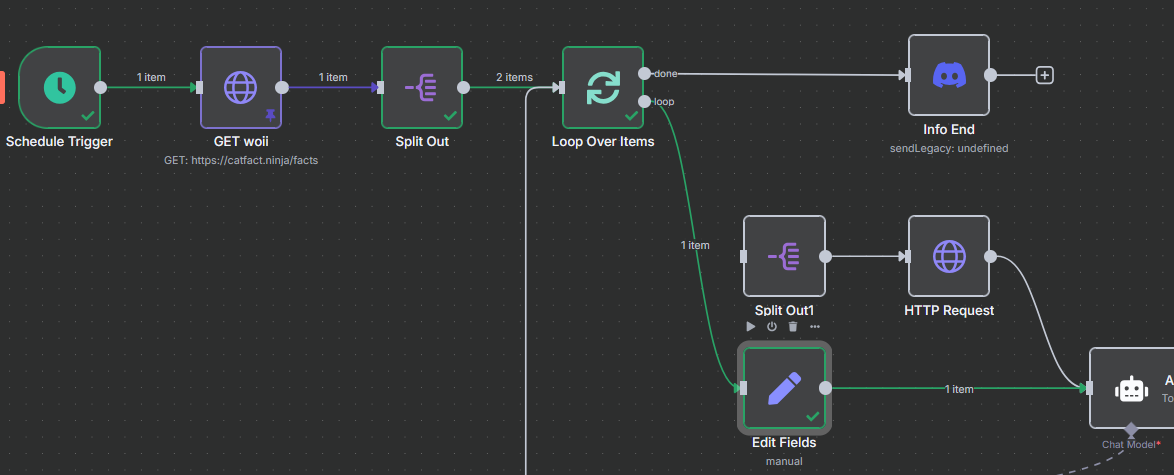

running just the edit:
