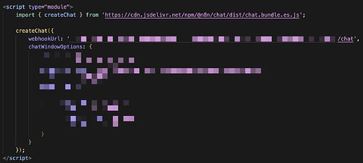

You might need to provide the code and screenshot about how you set up the n8n bundle js on your frontend.
Something like:
Hi
I am using the direct live chat URL
but when using embed code is something like
<html>
<body>
<link href="https://cdn.jsdelivr.net/npm/@n8n/chat/dist/style.css" rel="stylesheet" />
<script type="module">
import { createChat } from 'https://cdn.jsdelivr.net/npm/@n8n/chat/dist/chat.bundle.es.js';
createChat({
webhookUrl: 'livechaturl'
</script>
</body>
</html>

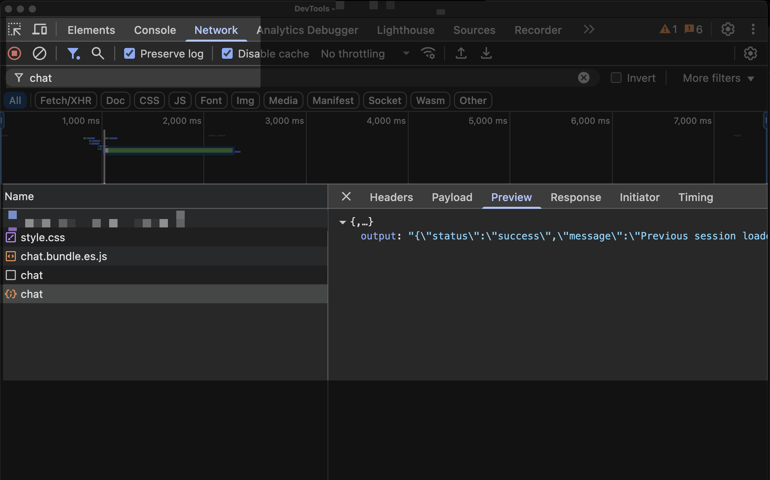

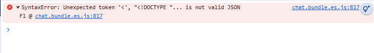

Looks like your request returned a html code which is not normal.
You can check the chat request to see if there are any error message as a html.
For some reason I cannot edit the other post (waiting for admin approval)

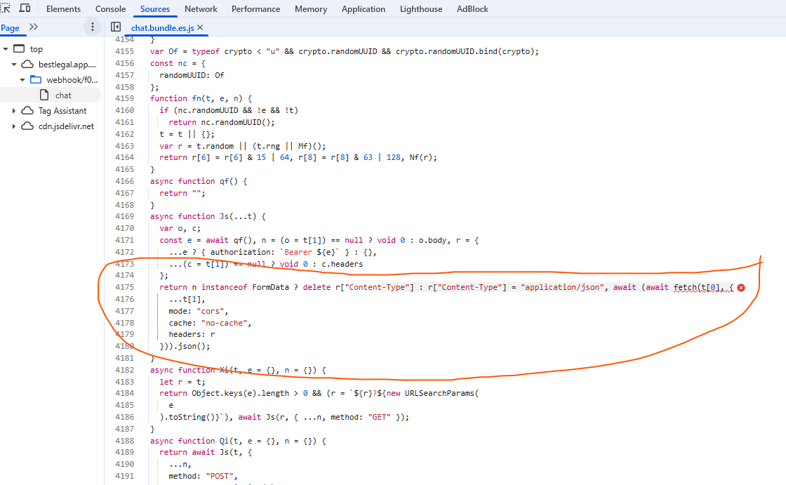

Here is the script error pointing at

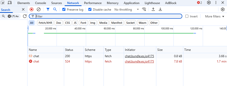

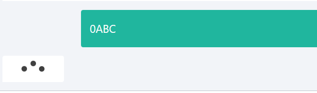

Using Live chat URL, this is the response I got
and it get stuck with 3 dots

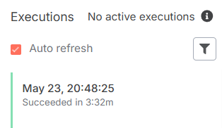

In the workflow, the execution is successful, no error
Found a similar issue here
Issue happening with Docker version of n8n as well. I am using n8n on docker(nginx) and own domain name. No Cloudfare involved
So basically your workflow execute too long more than 100 seconds.
n8n cloud version is using cloudflare so it happens.
Do you know why your workflow is taking so long to process the chat?

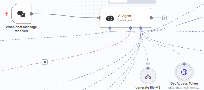

From what I can see, you’re connecting a lot of tools.
That might be one of the reasons for the delay.

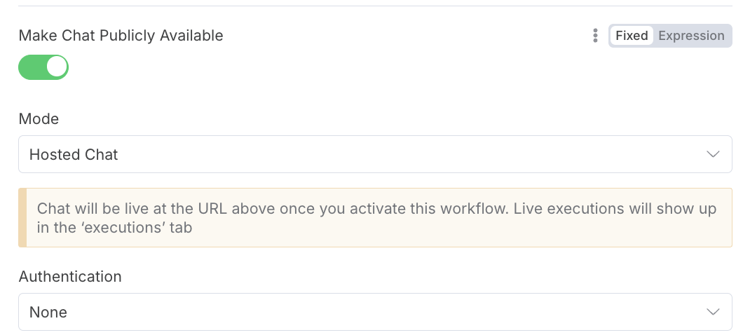

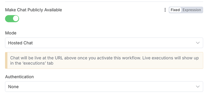

Do you have to use embed, I use hosted chat, and iframe it in,
I have a lot of API running in the background for file conversion which take like 30-60 seconds per file so it will like take more than 3 to 5 minutes to get executed excluding ai workflow processing time.
