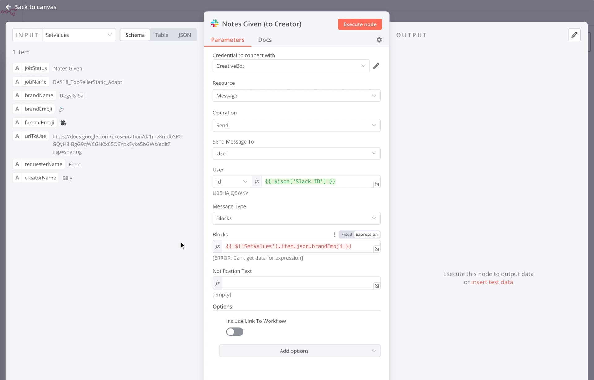

I’ve repeatedly run into issues attempting to pull values from previous nodes, typically when those nodes are more than 2 nodes back.
The only way I’ve been able to resolve this is by adding extra Set nodes to reset values that are further back in the chain.
Please see this video for reference: Dropbox - n8n_carrying-values-issue.mov - Simplify your life

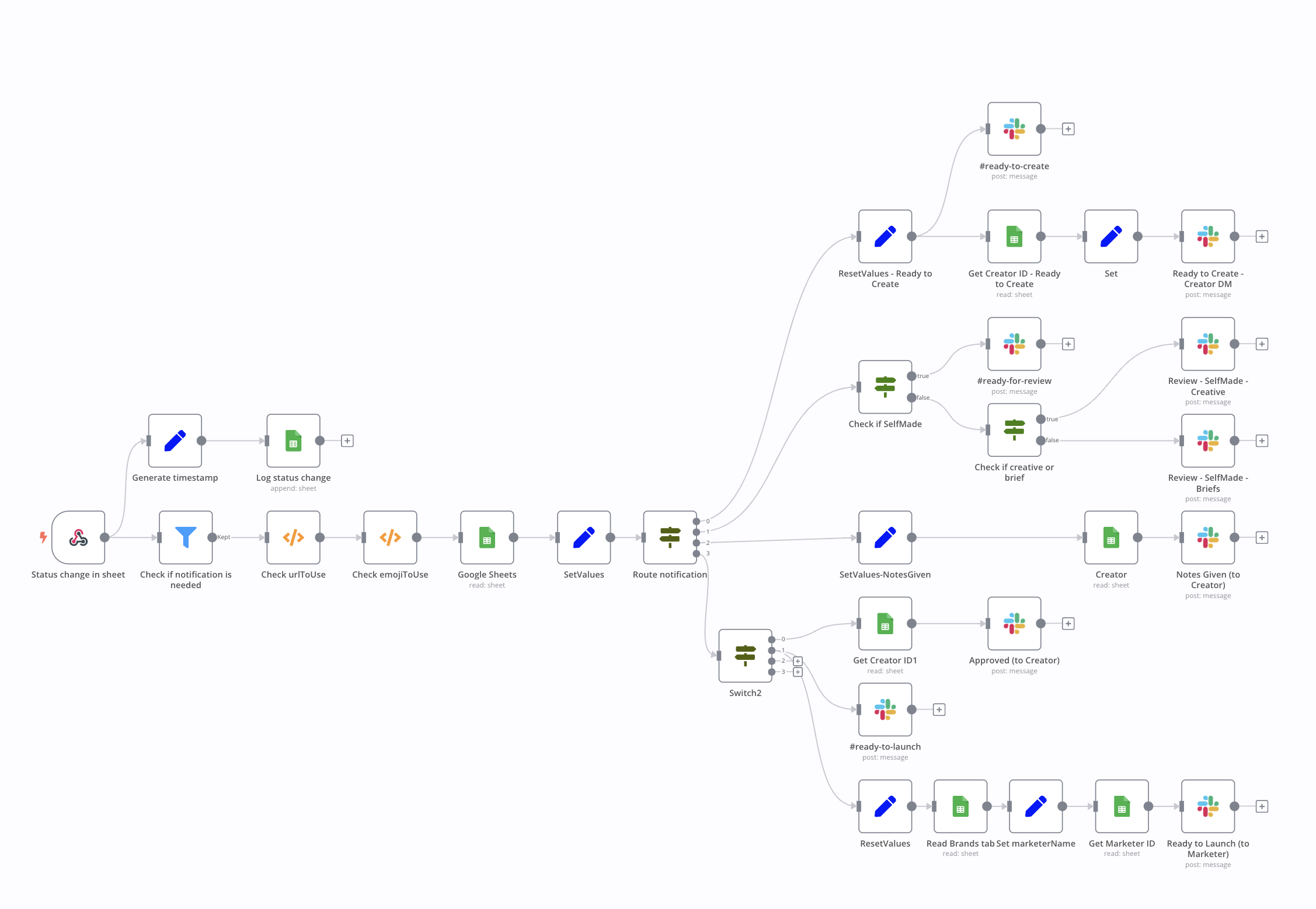

In the above video and screenshots, my ‘SetValues-NotesGiven’ node was the workaround used to reset the values needed. However, the ‘SetValues’ node (4 nodes back) contains the exact same data, but for some reason throws ‘[ERROR: Can’t get data for expression]’ when I try to use it in my node.
If possible, I would like to pull values from the original ‘SetValues’ node, instead of adding many unnecessary Set nodes throughout my workflow.

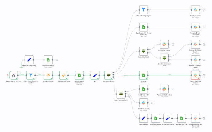

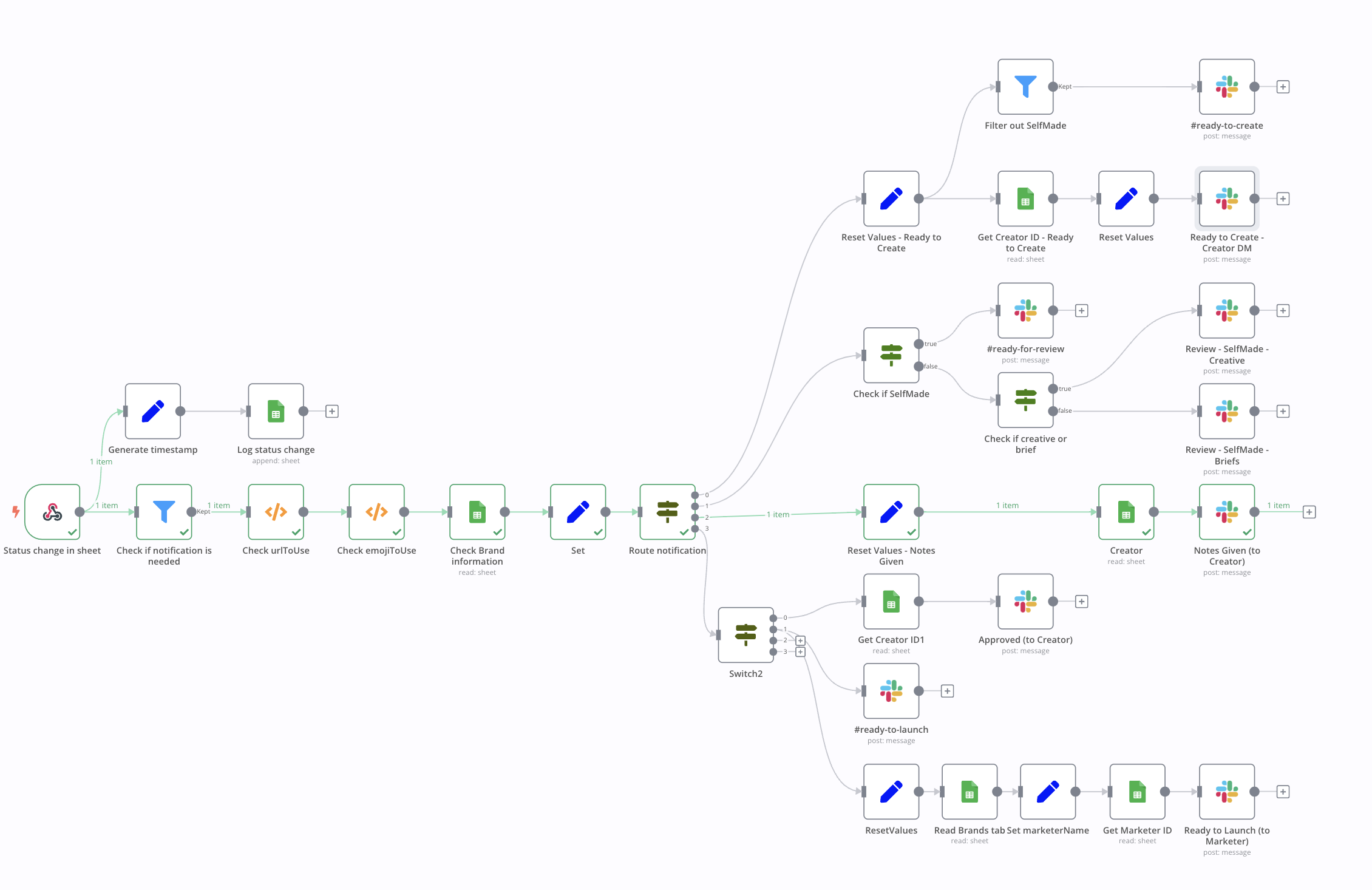

Here’s a screenshot of my full workflow. You’ll see that there is a switch node before ‘Nodes Given (to creator)’, which may be part of the issue per your comment. There are also code nodes, which produce some of the values I’m attempting to connect.
All of the Set nodes (aside from ‘Generate timestamp’) are used as a workaround to reset values that I can’t get data for, presumably because they’re too many nodes back.

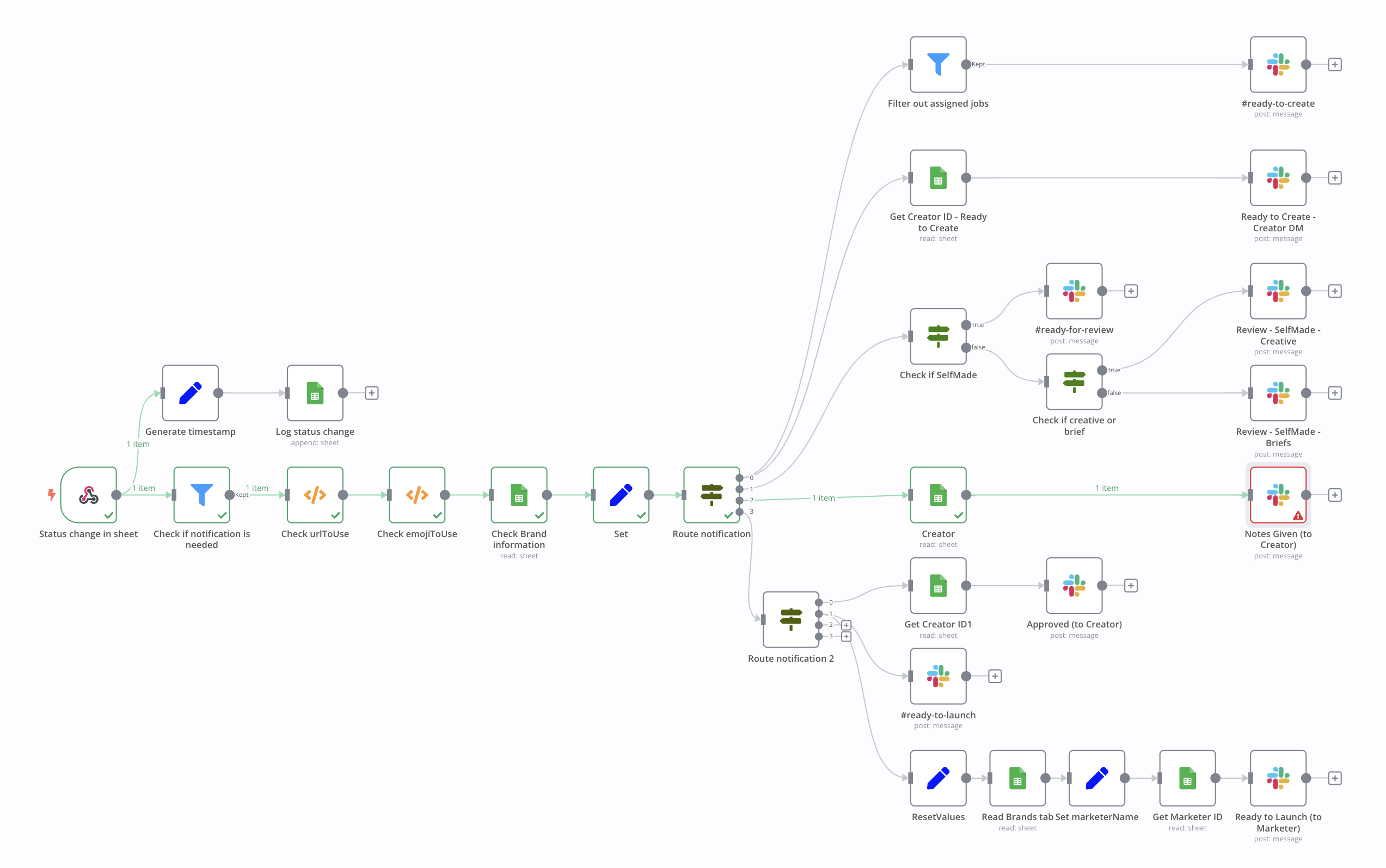

Could you execute the workflow and show the same image but with the coloured lines so I can see the route that has been taken?
Apologies for not sending this previously. In the screenshot above, the ‘Reset Values - Notes Given’ node is redundant and ideally could be removed.

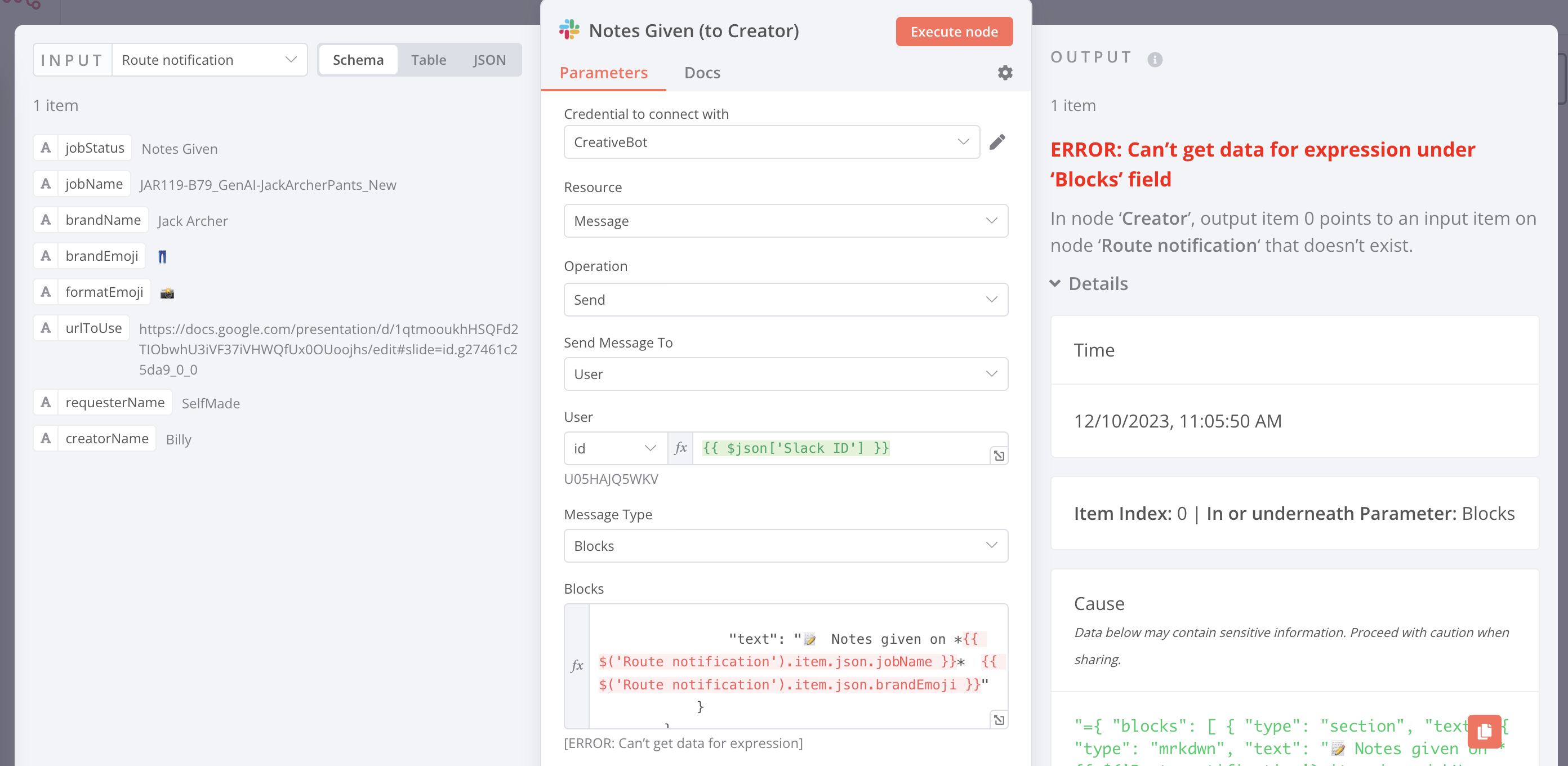

Here’s a video that demonstrates a bit more detail: Dropbox - n8n-issue-demo.mov - Simplify your life
You’ll see that the workflow breaks when I delete the Set node - although the same values live in a prior node and display in the left sidebar, the data does not come through when I use those json expressions in my code.
Is that only an issue in the UI or does it actually also fail when you execute the workflow in production or when you press the “Execute Workflow” button?
Great catch. Sometimes that is the case (I was able to remove the ‘Reset Values - Ready to Create’ and ‘Reset Values’ nodes near the top without disrupting my workflow).
However, I tried doing the same with the ‘Reset Values - Notes Given’ node, which resulted in failed executions:
It seems a bit unpredictable when ‘can’t get data for expression’ will/will not result in a failed execution, but perhaps there’s a rhyme or reason I’m not seeing.
