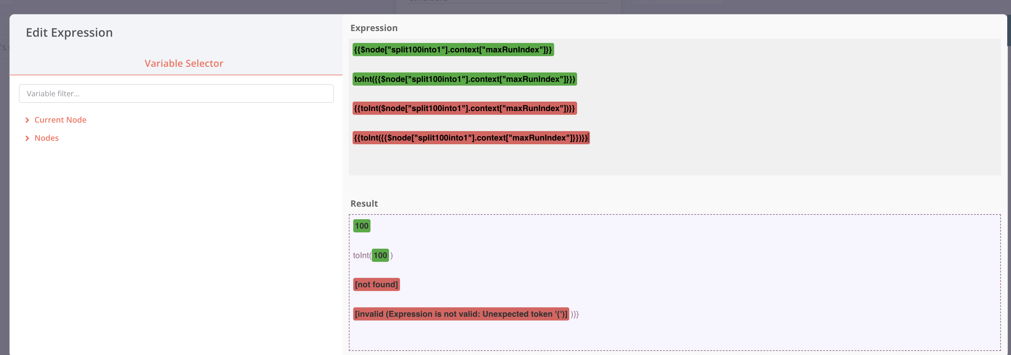

Hey community - would this code fix number comparison issues?
{{$node[“split100into1”].context[“maxRunIndex”]}}
toInt({{$node[“split100into1”].context[“maxRunIndex”]}})
{{toInt($node[“split100into1”].context[“maxRunIndex”])}}
{{toInt({{$node[“split100into1”].context[“maxRunIndex”]}})}}

![Screen Shot 2022-05-27 at 5.11.05 PM|690x242](upload://pzN8nR7cFXIlc64Xk2cTzXR2U3w.png)
![Screen Shot 2022-05-27 at 5.14.49 PM|690x147](upload://AqWfR8mDgzupAl6XS9MSj1OZB6k.png)
