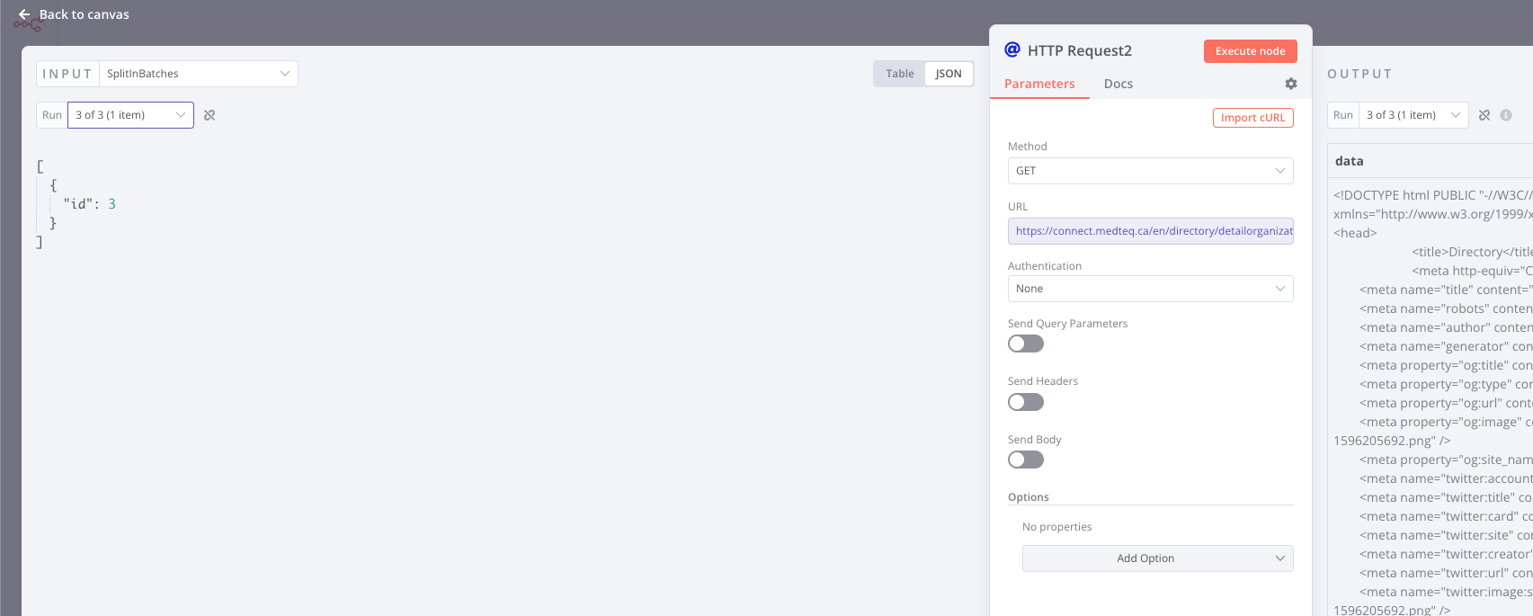

So far I did the setup using for sure SplitInBatch + Excel sheet for the numbering
It does the loop, however it outputs only the same page, not sure what is missing to get the counter of the page working in the loop of the HTTP Request.

in your Http Request node, instead of using this expression
could you try using this one
Also, does it work without using SplitInBatches? The HttpRequest node should go through all input input items by itself.

I tried the {{json["id"]}} instead, still didn’t work.
I tried without the SplitInBatches, and it kept looping!
What I noticed that the SplitInBatches is working fine, and the counter is working as you can see from the left side in the screenshot, result 3 shows Id 3 and so on.
However, the http request node doesn’t get updated with that input for some reason.

I had to click on the current node and not to type manually the {{json[“id”]}}
With that it worked! Strange, but it worked!

glad to hear it worked. When you are in the expression editor both methods, clicking incoming data on the left menu or typing expressions manually, should work. I can’t really tell why it did not work for you.
Now that you aren’t using SplitInBatches anymore I think you can remove your loop. The Http Request node should go through all incoming Google Sheets items.

The loop was removed and removed the SplitInBatches and it worked!
This time it worked and dumped all the data at once in the result instead of going one by one (interesting)
